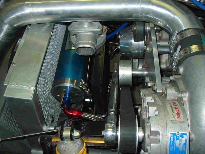

One from across the pond...
It serves for pre-lube duties only. My modded C6 Z06 is the track capable ride of choice.
Too many toys?? never!
Old 05-20-2013, 04:39 AM
750hp's Avatar
Posts: 4,381
Scotty OZVENOM mounted mine behind the radiator with a cable operated manual valve and the same clamps as undy. Worked like a champ
