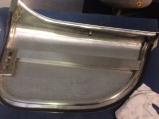

Started on the side intrusion bars had to go and get some nice stainless steel for the job. Stripped the carpet off the door the other day so then started working out how I could come up with something less cumbersome then the original idea that was suppose to go into the doors.
This is the door all stripped out.
http://www.clubcobra.com/photopost/d...0/image171.jpg[/url]
Then I started to machine the bar I decided I would weld the bar to the door frame as it will make a neater job then welding a heap of plates to the bar and bolting it in so I started out with machining one end of the stainless on my mill so I got everything nice and neat and square.
http://www.clubcobra.com/photopost/d...0/image174.jpg[/url]
After I machined that end it was simply a matter of getting the length right and using a port grinder to match it all in to the
http://www.clubcobra.com/photopost/d...0/image175.jpg[/url]
http://www.clubcobra.com/photopost/d...0/image173.jpg[/url]
This it all machined up and a check fit before final clean up and the to weld it in place.
http://www.clubcobra.com/photopost/d...0/image176.jpg[/url]
This is the finished job it actually looks good in the raw but I still think I'll upholster it an fit some map pocket to make it look a bit neater.
http://www.clubcobra.com/photopost/d...0/image178.jpg[/url]
I also got the time to fit the door catch lugs, I used stainless again for these had a sheet metal guy around the corner bend them up and the machined the lugs to fit and bolted the plates to original Kirkham door catch mounts. These came out pretty neat not sure if I'll leave them as is or make some covers.

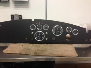

I also finished up my dash board while I had a bit of time so fitted off all the brake warning and seat belt lights. Dash looks awesome everything nice and neat.
http://www.clubcobra.com/photopost/d...0/image169.jpg[/url]

Aussie Mike 03-20-2014 04:34 PM
Looking good.
Is the one bar going to be enough for engineering? I've got 2 bars that size in my doors.
d488y2 03-20-2014 04:53 PM
The dash looks great, clean and simple. How did you go with the Cats for the exhaust?
damage 03-21-2014 04:31 AM
Aussie mike, the engineer said that was fine due to the frame for the door as well as the car itself .

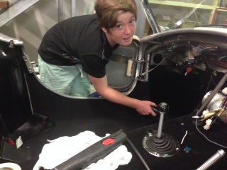

damage 04-09-2014 07:33 AM
I actually got some time to work on the car tonight, the minister for war and finance had one of those Sheila's makeup parties so I was told to make myself scarce.
All boys were ordered away from the house so I commandeered some help.
http://www.clubcobra.com/photopost/d...0/image188.jpg[/url]

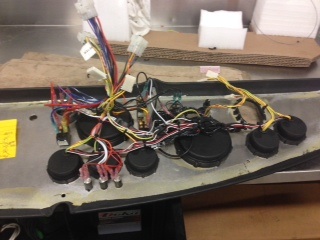

Started by tidying up under the dash I had to pull all the wiring down again when I installed the new computer so it gave me a chance to neaten it up a bit more,I fitted plugs to all the wiring so the dash is quick to pull out of the car again if ever the
http://www.clubcobra.com/photopost/d...0/image190.jpg[/url]
Then I finished off the dash with its plugs and bundled everything up as well.
http://www.clubcobra.com/photopost/d...0/image192.jpg[/url]
http://www.clubcobra.com/photopost/d...0/image194.jpg[/url]
All the wiring is now finished, side indicators, third brake light, dash warning lights brake warning seat belt warning and hand brake warning etc

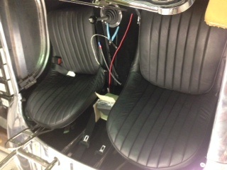

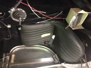

Then I bolted my headrest on the seats I've kept with the stainless theme and used 316 Allen heads
http://www.clubcobra.com/photopost/d...0/image187.jpg[/url]
Seeing how the under dash wiring is finished I also decided to bolt the seats into the car
http://www.clubcobra.com/photopost/d...0/image189.jpg[/url]
http://www.clubcobra.com/photopost/d...0/image191.jpg[/url]

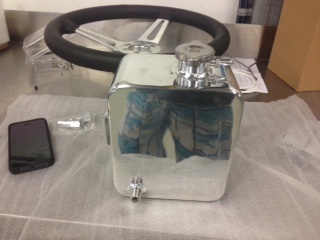

I've been looking around for an overflow tank for my radiator, hadn't found anything that would fit nice but got a nice polished one a couple of weeks ago now just have to fit it.
http://www.clubcobra.com/photopost/d...0/image195.jpg[/url]
