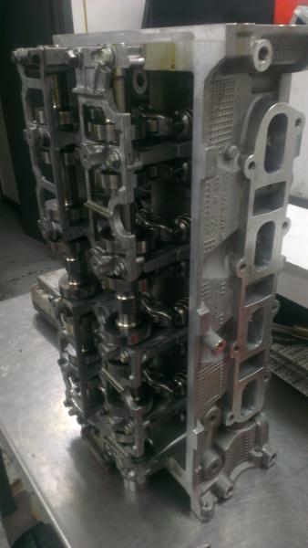

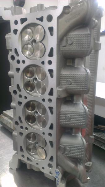

So I decided to put the Cammer together myself with the guidance from HTP and it made sense to package the parts together and time frame was not to much of a concern until the crank was the only thing not supplied.
The heads are already built by Head Stud technology with cams from the 5.4L motor which failed they are ported with oversized valves.
http://www.clubcobra.com/forums/pict...ictureid=11519
http://www.clubcobra.com/forums/pict...ictureid=11520
