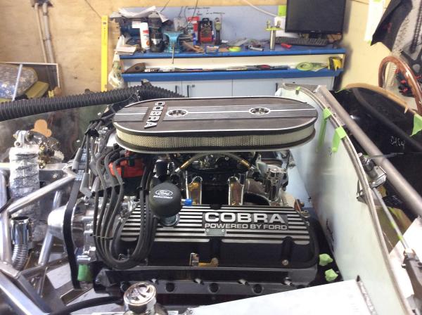

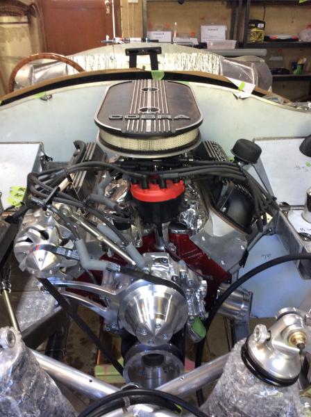

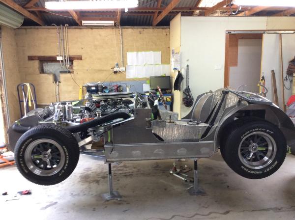

mudbrick 02-27-2016 06:33 PM
Progress..........and a lot of green tape.....red tape to follow
[IMG]http://www.clubcobra.com/forums/pict...ictureid=15041[/IMG]
[IMG]http://www.clubcobra.com/forums/pict...ictureid=15040[/IMG]
[IMG]http://www.clubcobra.com/forums/pict...ictureid=15047[/IMG][IMG]http://www.clubcobra.com/forums/pict...ictureid=15048[/IMG]

Tenrocca 02-28-2016 02:18 PM
Nice work. How far is the engine offset to the left? Looks like a couple of inches
mudbrick 02-28-2016 03:45 PM
Yep..........give or take
albanycobra 02-28-2016 04:14 PM
Why the offset?
dhs.buckley 02-28-2016 04:56 PM
i like a lot, and yes why the offset?
mudbrick 02-28-2016 06:21 PM
Originally Posted by albanycobra (Post 1382298)
Why the offset?
Trans tunnel/diff are all offset to pass side
Graig (AP) may chime in here with a more "Technical" answer
Wazza 02-28-2016 07:07 PM
There is an offset for the engine /gear box...but it is certainly part of the design.
Many sports cars/performance cars are made with a similar offset ( Including original Cobras).
It helps get all of the "cross weights" correct.
It assumes that in high performance situations there will be one driver/no passenger...and it makes a much better balance race car.
Don't worry...it doesn't mean it's not safe with two people on board.
Warren
Zedn 02-28-2016 08:30 PM
would help with space for pedals and brake booster also.
Wazza 02-28-2016 09:49 PM
Yes...quite right.
The offset not only gives a better balance...making room for the drivers will always be helped with that offset.
Warren
