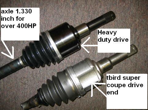

2. Do a subframe conversion to accept the Ford 8.8 diff. There is a company in the USA called Vorshlag who make a retro fit kit . They put LS V8's into E36 BMW's. The problem with this conversion is new 1/2 shafts, drive shaft mods etc etc and you can only source 4.30 ratio's which is close enough I guess.
3. These guys Home Page do a conversion kit where they modify the cradle of the BMW mid case diff to suit the larger Beemer large case diff. These centres have a 210mm R&P and are set up to run into the 800HP range. Again, I'd need new 1/2 shafts etc etc but on the down side the larger diff centres used in the BMW 750il V8 and V12 BMW sedans don't come in a 4.27 ratio. Only the 4.10.
