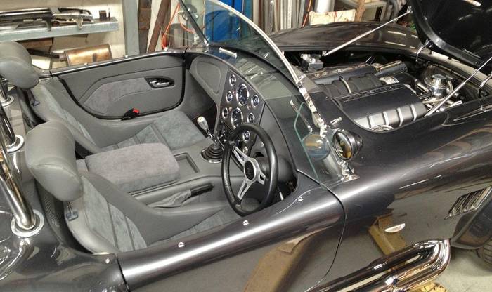

There's a grey Cobra seat on this website,that I've always liked.
Classic RS with Headrest | Cobra Classic Road Seats | Revolution Racegear
I ended up "making" a set of seats that were as close as I could get to them.

I have the mould....it belongs to one of the club members...but I'm sure he wouldn't mind if you want to use it.
I "skinnied" mine down a bit,because I had ideas of having the seats on runners so that my Darling could drive it ( shortish legs)...,and the tapered shape of the interior made me change the shape of the seat a bit to allow plenty of backwards and forwards movements....
But then....
I got the "$hits" with how high the seating position was when we were doing the interior trim, so........
OFF with the runners,and fixed the seat as far back as I could, and as it turned out,was still perfect for the bride to drive.
Im sure you'd be aware of the building method I used on the ENTIRE build,
....do EVERYTHING TWO OR THREE DIFFERENT WAYS until you get it just how you want it.!!
Warren

Keep an eye on Ebay for a cheap set of these Saas mach 1 seats:
Shouldnt matter how tatty they are. The have an integrated head rest which can easily be lopped off (it is a separate loop on the frame) - and get them recovered in leather. Should come in less than your budget. I know of quite a few people who have done this - it is quite a narrow seat and I reckon would fit in all cobras.
