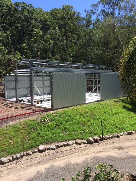

Well, after 150mm of rain the last few days and the swapping over of the incorrect wall and gutter material we are back into it full steam today. This morning it was still a frame but we have made progress.

Aussie Mike 12-14-2014 09:00 PM
Looking good Spooky. It really is in a nice spot. I reckon it'll be a great place to hang out.

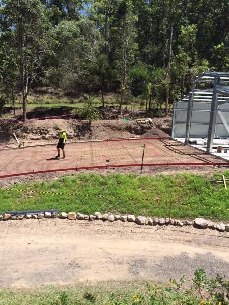

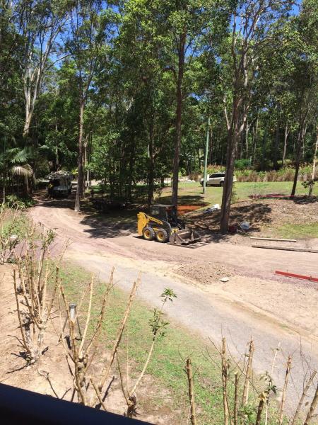

Here's what's happening on that front.
http://www.clubcobra.com/forums/pict...ictureid=13183
http://www.clubcobra.com/forums/pict...ictureid=13184
We're doing the shed drive pour first as it needs to be pre-set before next Monday as I have the roller doors going up then and we have to put the roller door trailer on it to hoist the doors. Praying the rain stays away.

How quick does that grass grow on the slope beside the shed spook! It was just soil last pic!

Yep co - op seed. It's good!

Bernica 12-15-2014 10:16 AM
Awesome project! And that's a LOT of concrete!!
Give it some time to cure before rolling the heavy stuff over it.:cool:

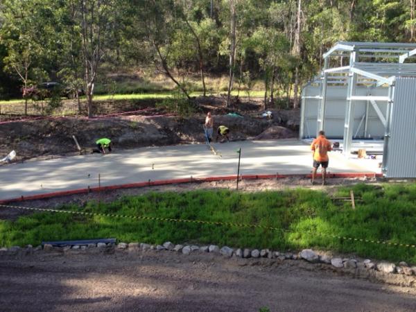

Let the driveway pour begin!
I love the sound of pouring concrete in the morning.

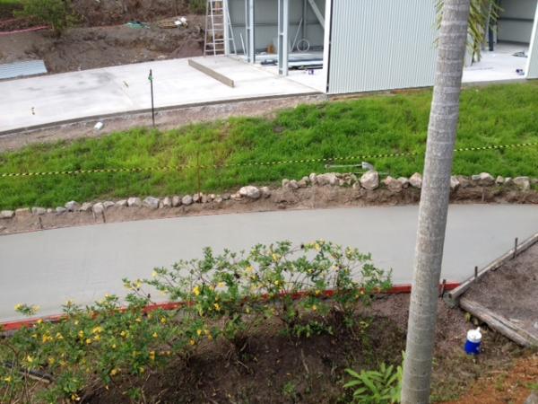

Top driveway. We get a bit of rain up here and I am at the base of a mtn so to help with water flow we've banked the edges of the slab so as the water will funnel down to my lower spoon drain. It should help in stopping my sloped bank getting badly eroded.

Bernica 12-16-2014 04:02 PM
Awesome!
Just make sure they are hooking and pulling up the mesh into the middle of the concrete as they go and don't let the mesh sit on the bottom after the trucks roll on it.;)
