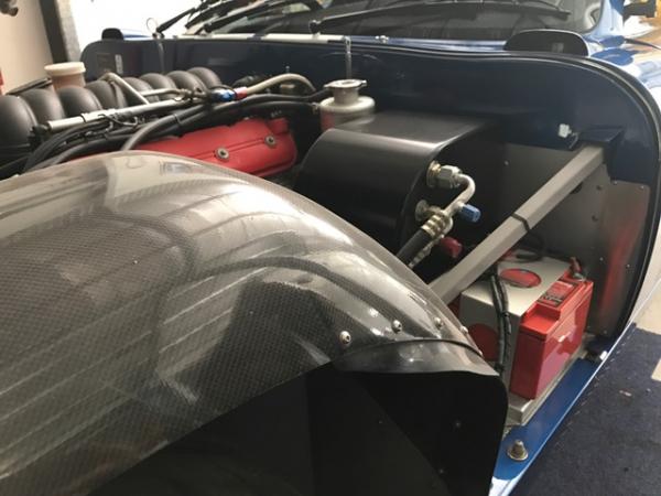

SydneyChris 04-27-2017 05:09 AM
3 Attachment(s)
Thanks gents.. :)
I had considered that a few feet back and to the side of the radiator duct the air would be sufficiently mixed to be relatively close to the ambient temp.
Mike.. I cant get the filter anywhere near that close to the underside of the radiator.. its sitting almost directly behind the upper lip at the back of the radiator ducting in a known hot spot on a Coupe as I moved the battery into the engine bay, blocking the path for an inlet of that type. It would also be feeding on air from the cooling system pipe directly underneath.
Noted re opening the back of the bonnet hump... that air is directly in the path of the radiator outlet, rather than to the side as a bonnet vent would be. Regardless, its a high pressure zone at the bottom of the windscreen, that would force air into the engine bay then out, either under the car or via the bonnet vents which is all positive.
I had already made up an insulated air box (aka OEM).. was thinking I could give plan A a go, easily revert to some sort of a scoop behind the radiator ducting if required and maintain the bonnet vents for cooling / engine bay air flow if one was not used as an intake.
The other benefit of the bonnet inlet was the slightly longer induction tube from the MAF to the throttle body, which improves the accuracy of the reading for the ECU. I cant get this extension of the inlet tube with the filter behind the radiator.
Option C...!! duct air in from the side of the bonnet.. aka Clubman style side draft intake.. !
Heading to a performance tuner in a few weeks... will get their 26c worth and update.. :)

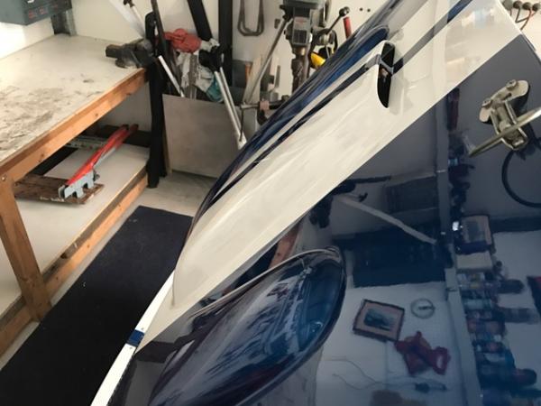

SydneyChris 07-23-2017 04:52 AM
4 Attachment(s)
Been fiddling with the hood while I the tuner does his thing.
Am conscious of time (elapsed) and wondering just how many Nats I will be able to miss at this rate.. ! Had a go at a NACA duct 6.5" x 2.5" for a cross sectional area which exceeds the 12 sq in of the 4" intake tube. To fit and finish this part its a lot less work than the plenum that would be required to run from the rear of the bonnet bulge to the intake.
A couple of the US guys have installed an intake duct in the fender, but by my calcs they wouldn't get the required air flow. While the NACA duct has the volume in theory I'll also check manifold pressure at speed when its going as a final validation. There is also the option to add a small hood at the rear of the NACA duct to capture more than the surface layer of air, although I wasnt keen on this because of the uneven disturbance it would also create. Second mod is to recess the area leading into the duct slightly to increase the flow.
Also made a couple of buckets with the 3D printer for the Pajero indicators (with thanks Ron F) to semi recess them, not dissimilar to the Superformance set up.
Will update when I have a car to fit the bonnet too.. :)
