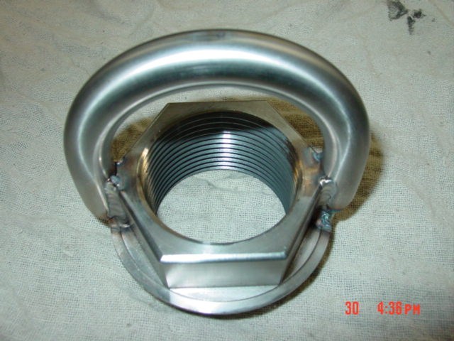

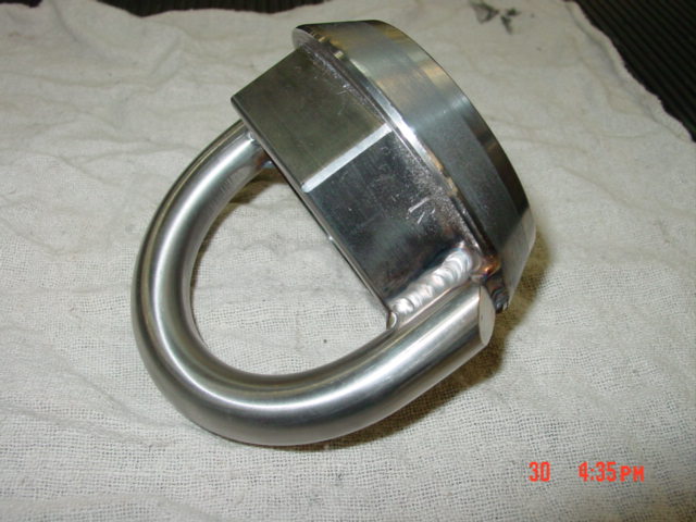

You might consider doing what we do..... the Cobra is to low to get under .... so we made these extra nuts to tow with and change when we are ready to drive.
Hey Morris,
How much for you to mock me up a set of 4?
Thx

Dimis
Those are SS nuts and SS bar stock formed and welded to the nuts......the bar has to be welded at exactly the same place on each nut just so you can buy a 2 3/4" socket and slot the sides out of the socket so you can take the nuts on/off with a 3/4" impact.....
The nuts cost me $100.00 each and the bar stock and fitting and welding about another $100.00 each.....
I think you could accomplish the same thing using aluminum nuts and bar stock......for less money.....I had a spring mfg bend the loops for me as the are about the same size as a axle....
Hope this helps out....
