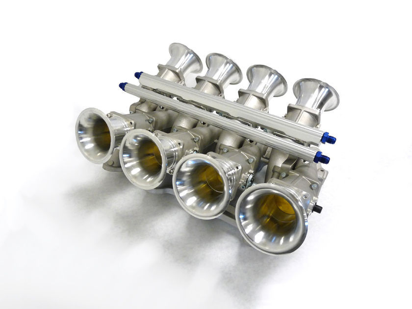

I am toying with the idea of fitting a set of 8 stack, down draught webber look-alike Borla 50 mm Throttle Bodies onto the top of my LS2. I was wondering if the Throttle Bodies will fit under the bonnet or will the scoop have to be modified. I have tried to measure the current distance from the top of the current inlet manifold to the underside of the bonnet without much success. My Cobra is a 2007 RMC which is similar to a Harrison and or a Classic Revival. Has anyone had a similar dilemma and how did you solve it? The Part No for the Throttle Bodies is 20043.

I was looking at throttle body induction as well.. Harrop do a nice carbon fiber 8 trumpet inlet which is lower profile than the style you mentioned and uses the standard TB actuator. LSX parts sell them along with a few others I expect..

I've seen these OBX 8 throttle body kits on US eBay lately. Price is pretty good even with the crap exchange rate.
OBX Intake LS2
Or if you want to go with a local supplier you could check out Stack Injection who supply Aussie made DC&O setups.
Stack Injection | EFI Manifold | Individual Throttle Bodies

If going 8 stack, it's my understanding that the longer the length of the runner, the better chance you're going to have tuning it for street use, between 1000-3000rpm. Fortunately for you Baz a lot of the LS series 8stacks are Cross Rams. Resulting in proportionately longer runners, yet a lower profile intake system.
Fwiw: ...and I don't mean this to put you off trying, but under the hood of a cobra, (and scoop), air pressure and air speed varries greatly, and disproportionately, with the vehicle's speed. Tuning these things on a dyno, won't replicate real world driving. They are a pain in the a55 to tune right!
