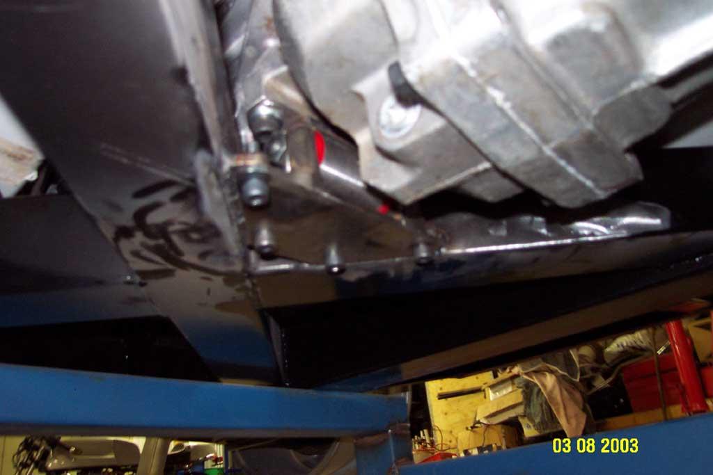

I finally got the gearbox mount and crossmember finished. It's turned into a steel and eurethane sculpture but it looks like it'll work a treat. The T56 is a very long gearbox and it doesn't leave much room for a mount on the Classic Revival chassis. I had to slice off the original cross member mounts and fabricate a whole new set up.

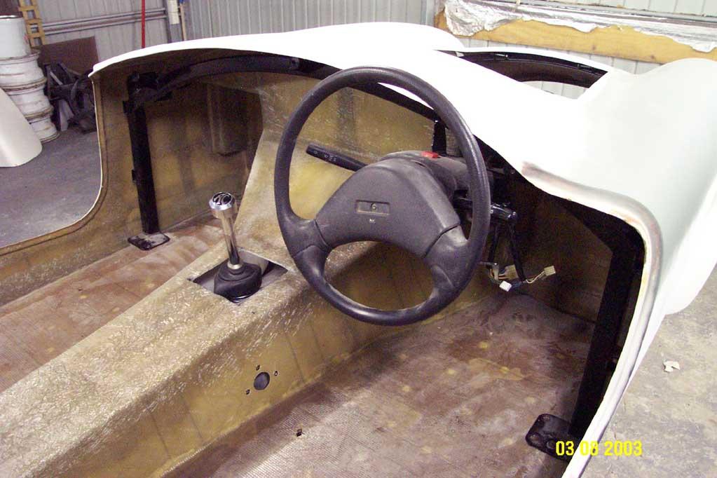

I dropped the body back on to work out the clearances for the headers. I took the opportunity to check out what the relocated shifter was like. I spent at least half an hour sitting in the car and making broom broom noises whilst shifting gears. I'm very happy with how the shifter has turned out.

Tell ya what tho...you wouldn't want that box any longer mike..just fitted before that X member.

Actually had to trim a bit off the gearbox to get it to fit. Used a die grinder and took about 8mm off each rear corner of the mounting flange.
