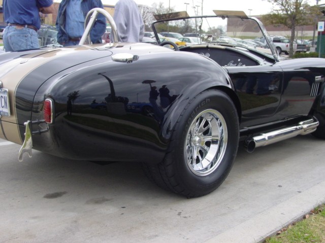

Need a bit of extra sidewall? How about the BFG 325/50/15 Drag Radial? Mustang drag racers are running 8 second timeslips with this tyre !
Oh yeah.... how about that Garrett guy You guys are so heartless. Never met the guy, but anyone that owns an SPF with that much mumbo can't be all bad.
