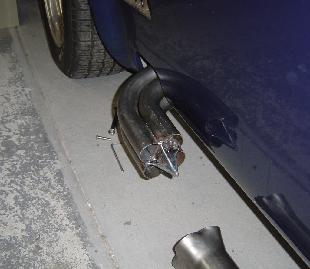

I'd been waiting ages for the 5" radius bends to come in for where they exit through the guard. The seems to be only one bending shop in the countyr that has dies for this wide radius. The tighter 3" radius bends for the inside pipes are common and there are other wider radii that are close but the 3" and 5" fit together perfectly.
Here's a couple of pics showing the merge for the collector:

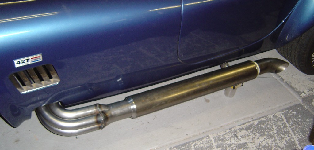

Here's a pic of the welded collector and the muffler body in place. I'm just working out the positioning before final welding:
I left a bit more of a gap between the body and the sidepipe on Bernies car. When I did mine I put them closer to the body but thinking about it I reckon this will make for skinned knuckles when trying to wash and polish the paintwork behind the pipes.
The pipes will be ceramic coated black and should look and sound great when completed. I'll have some more progress shots later in the week. Hope to fire it up next week end and hear what it sounds like.

The pipes look great. Don't worry about getting to close to the body as I don't wash the Cobra anyway. Would prefer closer to avoid burns to pedestarians..

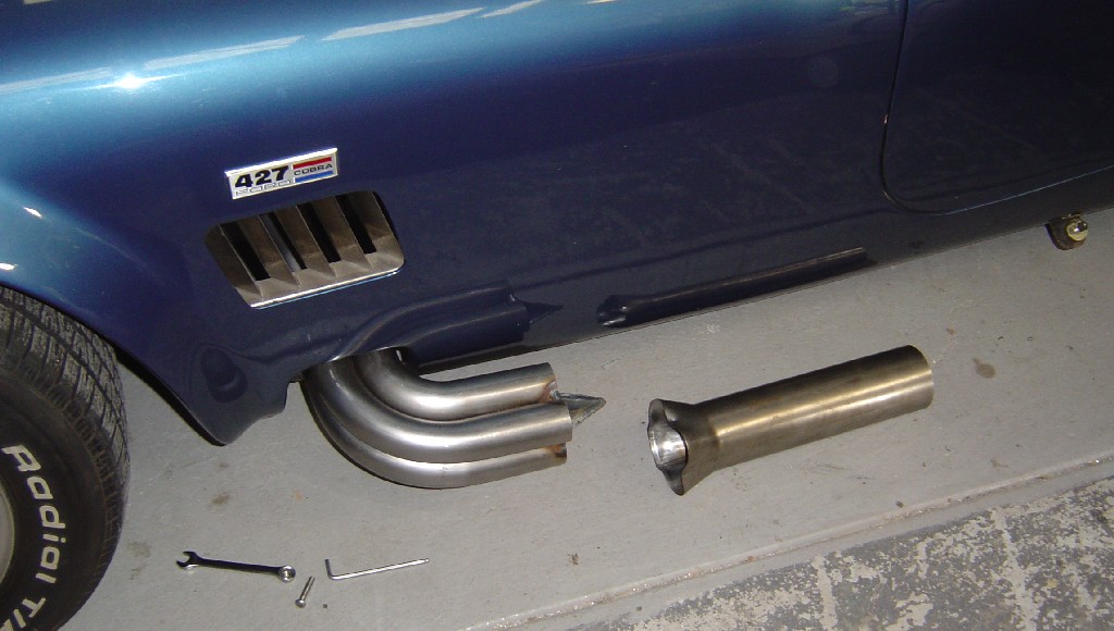

Mike, what are you using for mufflers, and any additional baffles ?

The baffles are removable and repackable. In the past I've made them from 2 1/2" perforated tube. I may need a different design to get down to the noises levels Bernie wants.
The advantage of the removable baffles is that you can tailor the sound to suit the situation/application. I'm making some free flow baffles for Bernie to se on the track and some quieter ones for the street.
I should have some pictures of the completed baffles on the weekend.
