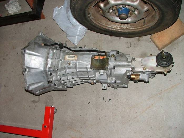

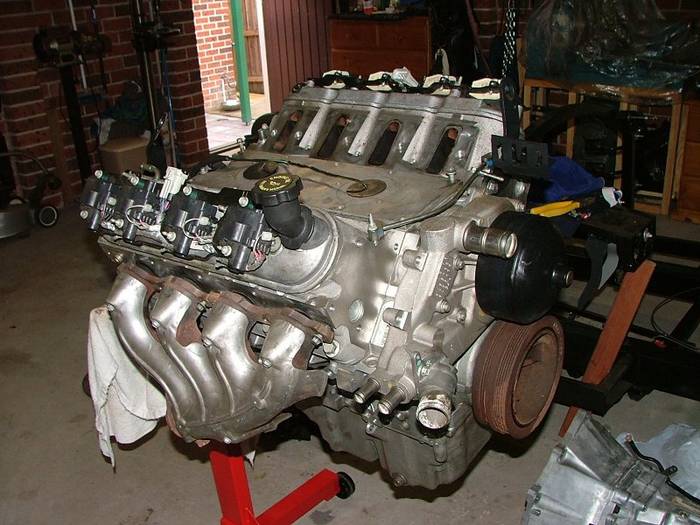

Well we have some new bits at home. Picked up the engine and gearbox. We will have to start work on them to have them ready to go in. Gearbox does not need a lot of work, however the engine is shy of a fews bits.
We need a wiring loom, throttle body and various other bits. The engine has been laying around for a while so we are going to take it apart and put new bearings, rings and valve springs in. The price we paid was way to good to pass up, so we didn't.

As I sad Mark, the gearbox clearly is not the one you and Pete intended to put in the car, so I reckon you should sell to me, for lets say, a carton of Carlton draft??

Thanks Mike, the Dark side is getting stronger. The federation is gaining strength.
Andrew, mate, make it a case of Crownies and you may have a deal..... Hang on.... Bugger that.... how about an LS2 ??

Default The heads are off
Well, we took the heads of yesterday and everything seems to be in really good nic. However we are going to do rings, bearings, and timing chain. The valve springs look OK, so we are not going to do them.
So the parts list so far is throttle body and a starter motor.

Churchy,
The one must do thing on a Gen111 is the valve springs. I just happen to have a set of Comp 918's available ...only done 500km's. Catch up at the Cobraholic meeting.
Try ebay for the starter and TB.
Phil

Craig,
Sure Am.by Nathan Higgins.
