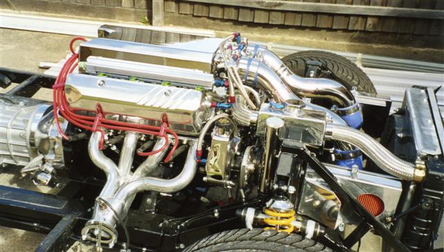

Default Sweet
That's one sweet lookin ride
Very nice engine bay
...mmmmm....shines like precious
LoBelly
