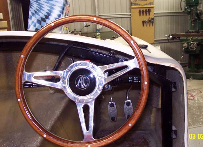

Are you looking for something like this?
Mike Murphy
Melbourne Australia

Thought I would resurrect this old thread with a related question. I'm looking to buy the 9 bolt moto-lita wheel from finishline while the dollar is good and I thought I would see if anyone has used this combo before making a phone call to the States.
I have an early 90s Ford Laser column in my car. Does anyone know whether the following boss adapter (Ford option) will fit directly onto the column?
Ford is Ford, right?
Boss Adapter, 9 Bolts. And the wheel is here.
There's a similar one on snakebite (below) but without an adapter on the back. Eg, Moto-Lita MK3(9 bolt) Steering Wheel Adapter
Any thoughts?

Ford's not Ford when it's actually a Mazda 323. That's what a Ford Laser is underneath that badge.
I got a standard 6 bolt boss which is pretty common. I bought a SAAS one as they were a one piece aluminum casting that I could machine the surface of (Many are made with a plastic sleeve over the outside). I then machined up an adapter ring to step from the 6 bolt pattern to the larger 9 bolt circle.

Thanks Mike. Where did you get that centre AC badge from? And does the horn work with that setup?

I have the same setup as Mike (he made it for me) and it all works wonderfully.

Including horn Dave?

Yep the horn works.
Here is a boss kit for column to 6 bolt, then Mike machined up an adapter for wheel to boss kit.
FORD LASER 1981-94 SAAS STEERING WHEEL ADAPTOR BOSS KIT | eBay

The one Mike made was similar to this.

The adapted pictured fits onto any 6 hole boss. Motolita do not make a lazer/323 boss anymore, instead they ask customers to use the adapter.
I bought a 15" Mark4 leather wheel, billet horn centre, 6 to 9 hole boss adapter, landed cost $450, direct from MotoLita. Snakebite were not even close to that price. The AUD is sooo good atm.
