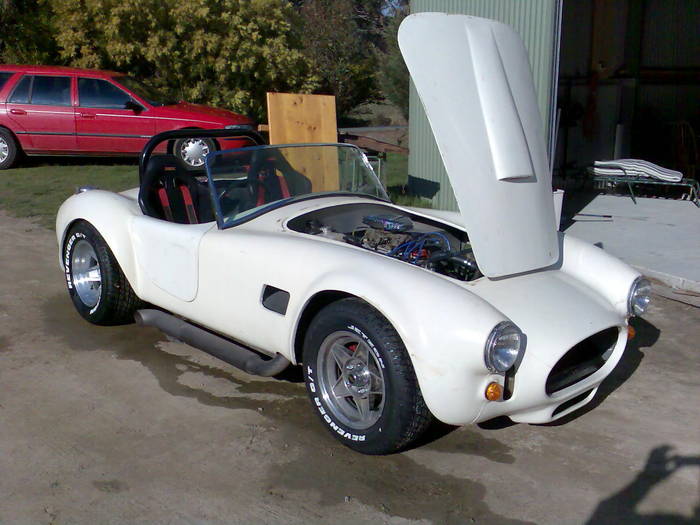

Hello All,
It's been a little while since the last set of pics so I thought it was time for a set of progress snaps.
This should be beneficial to all those other builders out there so you can see the folly of cutting corners and not spending the money you should - so be warned.
Last Sunday - was mostly spent moving furniture but the big rubber arrived so it was an opportune time to take some snaps.
Those of you with long memories will recall my earlier post on buying the first set of mags for the car, 4 wheels (15x7) for $150 advertised in the trading post - turned out to be Bathurst Globes - one of my all-time favorite wheels.
(for an essay on why a young ford fella might be smitten try http://www.aus-ford-uk.co.uk/html/details13.html )
But 7in on the back of a Cobra didn't cut it so I hunted around for someone who could supply a copy - found performance wheels in SA who dont deal direct with the public fortunately Trackside Tyres in Kilsyth deal with Performance and were happy to order the rims in for me $258 a piece for the 15x10
Here is the car mid - wheel change
I may have mentioned re-doing the brakes, my brother pulled the jag gear apart and after a good soak & scrub replaced everything (pistons/seals etc) and even had the forethought to get the flexible pipes remanufactured, get some good pads and some paint - I helped operate the vice
Another addition since my last post has been the roll-bar and harnesses.
My Brother found this local (to him) engineering shop that was happy to bend and cut and make two roll bars with perfectly fitting cross-bars out of stock that we supplied ($175) for $50 cash. Which was all going swimmingly until it turned out that my measurements were out by the traditional bees duck and an extra days effort was required.
Note also battery isolation and the emergence of a colour scheme - generally monochomatic with a splash of red (same with VDO guages)
Here is 'Old Smokey' the engine that came with the kit and has been press-ganged into service after sitting around partly disassembled for 15+ years.
This picture is for Les - note that its a RMC with a backward sloping radiator.
The standard RMC radiator (series 1) came with the kit and we just thought that that was what had to happen (before we got the manual) The brother worked like 10 men to get that to fit - I handed it to him after he crawled under the car so he could offered it up - took about 15 goes - I got a sore back but no sympathy.
Now that the plumbing is done and there is a big fan under the radiator is stays nice and cool - apologies to purists on the header tank. Next job will probably be to replace the cable ties with hose clamps for many of the cooling components
And one last photo to show the new rubber filling the guards - love that look.

Thankyou all for your kind words
and for that news flash Stephen.
My brother got a temporary permit today and so we did a bit of driving, even got to drive the car myself today.
During the test drives today we had an issue with the back of the car stepping left when we got off the throttle. Have redone the bearing spacers in the rear hubs to remove a little play and we'll see how that goes.
Old Smokey was a bit off on the first run and sounded/felt like it was pinging so we pulled in to grab some octane boost - one of the leads was off <doh> , after that the engine seemed pretty willing down low, but hasn't been happy to rev to hard - we keep thinking there should be more in there. But, we haven't put a timing light on it yet (can't find) - advancing the timing a bit by ear made a big difference so we'll have to look harder for a timing light.
My first drive was a blast - cruised around to begin with while getting the feel. The shifter is nice and smooth and clutch operation doesn't take much pedal so once I get the feel for the gates I expect I'll be able to move through those quickly. The car rides really nicely and feels great being out in the open. The side-pipes have only some home-made baffles that I thought up and I was worried about restricting the engine so they really only take some edge off. The cobra sits nice an flat and is very well behaved (apart from that earlier issue) The main drama I had was that my belly pushed the quick releas onto the steering wheel in one turn and it grabbed on the release and everything disengaged at once - eek.
Opened the throttle a couple of times in 2nd then up to 3rd, man - its so rapid - even with only a 289 and my tall diff. I expect those of you with your cars are going 'welcome to the club' to those of you still building - keep going your gunna love it.
Anyway - at the end of the day Old Smokey might not last - after sitting for so long the carbie took a rebuild to run properly and while doing the rear end some green liquid was spotted, so some detectiving was done and it looks like a head gasket. The expectation is that the big sit basically degraded a lot of stuff in the engine and so another is planned.
Build or buy - mild or wild - how much of what. Time to hit the spreadsheet.
