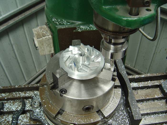

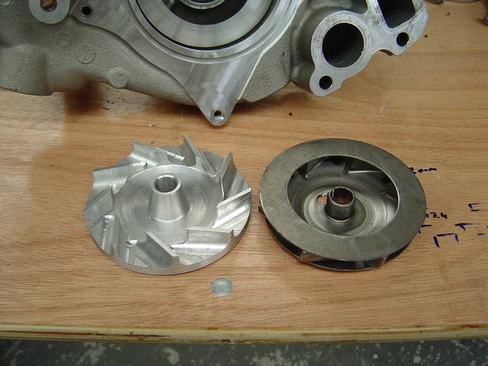

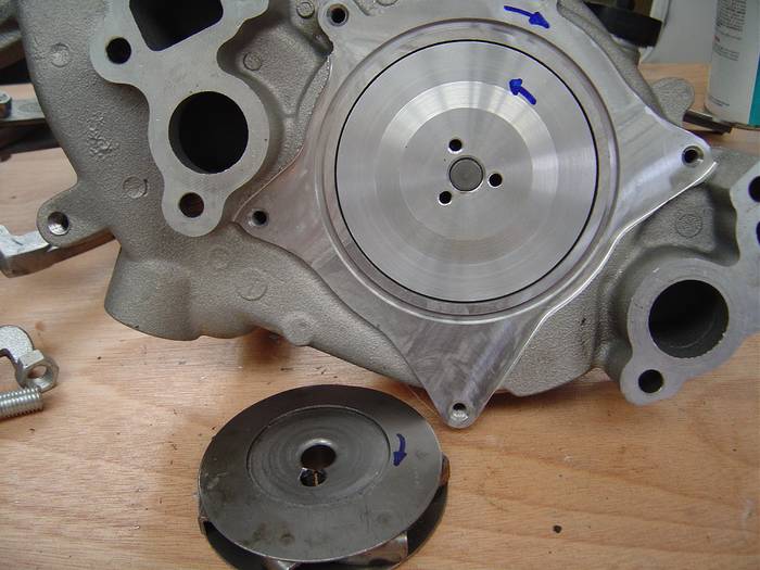

My water pump turns the same direction as the crank. Regular LSX series motors run reverse to the crank as they are driven off the back of the belt. I machined a new impeller for mine so I could run the pump in the other direction. Makes for a much neater belt setup.

Thanks Mike are the impellers hard to make ??
There was a bit of work in it but not that difficult. I spent a fair bit of time on the milling machine doing the blades and getting the clearances right.
There's a few pics of it in my gallery:
