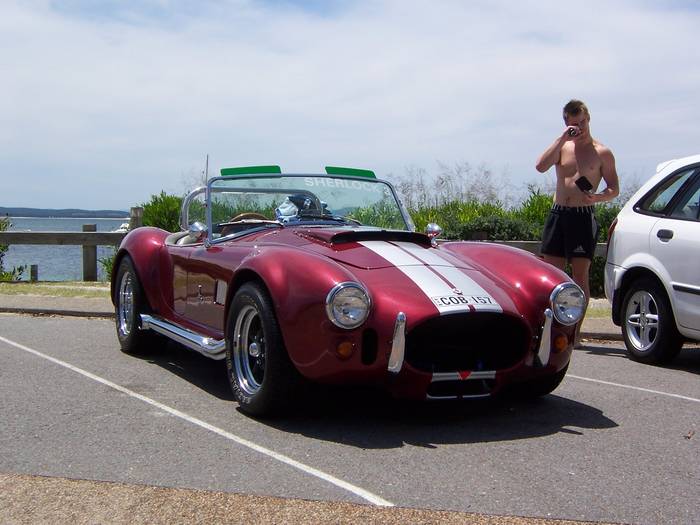

Here is a photo of my RMC post interior
Old 04-11-2007, 06:14 AM
Posts: 12
Old 04-11-2007, 06:23 AM

Dave - Nice car! Are all your trees in Newcastle on a lean or is it just windy?
