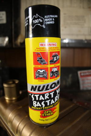

2 litres of crook fuel in 20 litres of new fuel wouldn't affect the starting of the engine. You've flushed the system...It should be OK. Try some "Start ya bastard" in the air cleaner duct.[ its an Ether based product by Nulon ] If it fires then you can look at dirty/ gummy injectors. Put some injector cleaner in the tank and you might be right. I'm no expert but I've seen this happen before.

Could not get "start ya bastard" but did get a carby throttle body cleaner (also by Nulon). Squirted some through a vacume line and it does start. Started about 10 times, runs for abou 5 seconds then stops.

"Start ya bastard"? Is that an actual brand name of starting fluid or something? I like it, sounds like good stuff!
Wierd that carb cleaner would help it start, it's generally not combustible. Just what kind of stuff you guys playing with "down under"? Ya'll got some mean chemicals down there.
