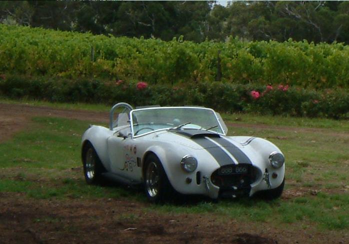

Mines been in grey gelcoat for 10 yrs now. G-Force supplied them grey.
I always wondered for chip disguise, if the same colour gelcoat as paint would be an advantage. Of course primer would need to be tinted.
You guys are probably sick of that pic by now. I will attemp to put some others in my gallery for these purposes. Most all the shots i have are on film not digital.

Old 05-17-2007, 03:19 PM

The Cobra looks great in the contrasting stripes. Mmm I would certainly leave it in Gel coat if it looked as good as your car there..
Can never get sick of looking at your Cobra David. But those V8 Supercar drivers don't help the quality of the photo though.
