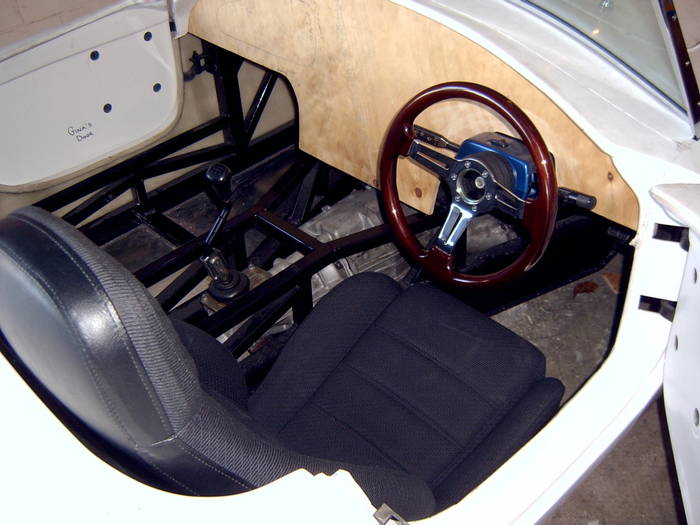

Posts: 474
Default Column controls
Mick
Here is an older photo of my column - there appears to be plenty of room for the indicator stalk.
Geof
