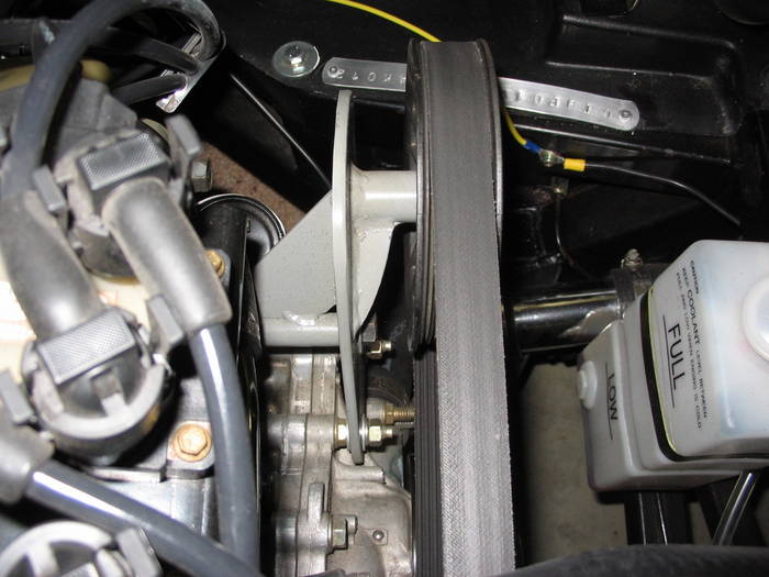

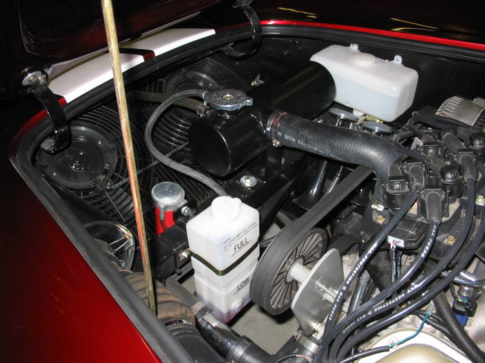

I have an AU 5 litre in my RMC, it is a new engine and came with a thermostat that opens at 89degrees, the thermo fans are set to come on at 90. The overflow/reclaim bottle works really well, it fills to about half and then sucks it back in again as it cools. The engine runs happily at 90 degrees.
[IMG][/IMG]

The only part I've been mucking up is the reclaim bottle returning fluid back into the system as I've been opening the cap after running. But now that the engine temp is under control, I will do some fine tuning and leave it all alone and see how it runs.
From your pic, is the big idler pulley one of the std ford pulleys? Is it smooth or notched ( won't say ribbed - sounds like something else??!!?) and how have you mounted the shaft arrangement, in fact what does this pulley revolve on?
I ask as I'm not so happy with my idler pulley arrangement and want to improve it!

As you can see from the photo's the pulley is grooved to match the belt. The mounting bracket was fabricated from a piece of steel plate, the two lower mounts are bolts that protrude from the water pump housing and the large bolt goes back into a thread that was in the head. I think the pulley came from a Jeep, I had a piece of bar machined to fit the pulley bearing and tapped for the bolt that retains the pulley. It's simple, but does the job of maintaining contact area on the water pump pulley.
