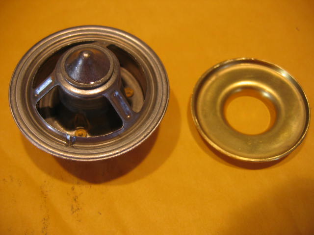

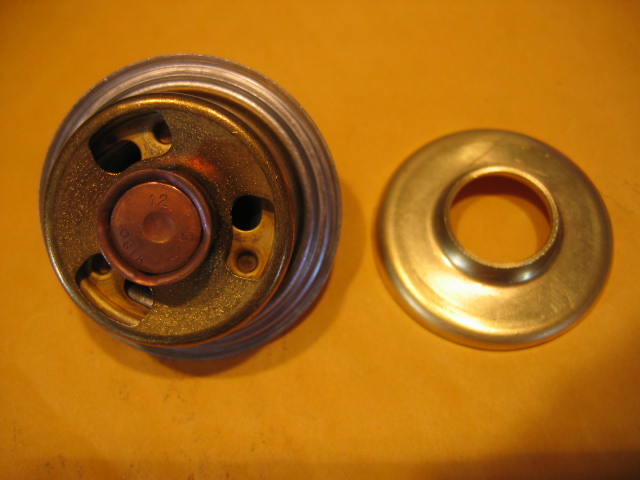

Default I found one!!!!
Thanks everyone for your help. i have managed to get one locally here in Melbourne.
These are a national treasure here in Aus. We are going to measure it up and perhaps get a few made up for us Cleveland hacks.
A picture for those interested!!
Top View (It's the plate on the right)
Bottom view
Ron,
I went to the Pantera website earlier this morning. It was very helpful and at least I know now that I can get one in the US if I get desperate.
Thanks again.
TC

Clearly not what I thought it was, by your description on cooling issues.
Does this fitting tend to cause recirculation until temp reached to minimise the time for the engine to heat up or has it a function to aid cooling at operating temperatures?
What temps were you running at Tony?
I ask as mine seems to want to stay cold, not much better than about 40 C, unless delayed in stop start traffic and then it moves to 85 - 90C when the thermo cuts in or more persistent forward movement achieves the needed cooling.
Your thread has made me wonder if I am missing a control mechanism as I replaced my thermostat but I don't believe my housing had been previously dismantled.
Does your thermostat have that nasty trick too of being ovaloid? Such that when you bolt it in incorrectly the first time you get all these coolant leaks until you re dismantle, swear and then put it in correctly again!!

Default Running too cold!
Stephen,
You may have a problem with your thermostat. My engine will hold at 85 - 90 from start up to running temp but if I give her a squirt or sit in traffic the temp slowly climbs to 110 and the thermo can just barely hold her. It's fine when on the freeway ie sits on 85 - 90 no problem but as soon as I get disruption of airflow or I sit behind traffic she climbs. I haven't had it boil from the radiator but I do find that after a longer trip and the car sits for a few minutes the block sometimes boils sending some coolant to the overflow. This seems to be indicatative of having too much bypass and the block is getting too hot.
The brass insert allows for the thermostat to block off the bypass back through the engine. Cooling is then directed more to the radiator. Without this insert you will be loosing more than 25% flow to the radiator. From all the forums I have read in the last couple of days it seems this insert is one part that is important and that you have the correct Thermostat for a Cleveland. The windsors are different as the thermostat comes off the front of the pump/engine. I am not sure of what setup the thermostat has. ie is it a bypass set up or does it bypass somewhere else. I believe windsors do not have this insert.
Jas,
I believe it is very very unusual for the brass insert to be missing. However, everyone I spoke with who new about clevelands said that some reconditioners/ engine rebuilders removed them if they were damaged (and then probably couldn't get one to replace). I believe some were cast steel ones (and were probably buggered), the brass ones should be fine.
One of the keys for me was even if I stop and leave the thermofan on the temp didn't move down. I still expect the old girl to get a little warm when I am on the track and in heavy traffic / hot days.
