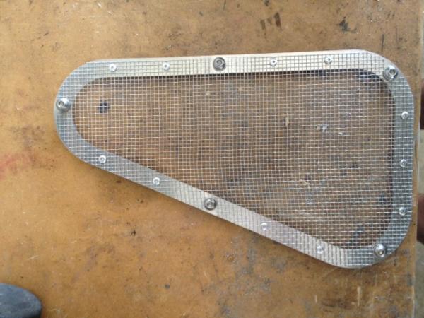

I used the blanket and trimmed it to fit. Used the heat hi temp silicon on the edges as Craig suggested.
It was under the GT40 rear clip.
