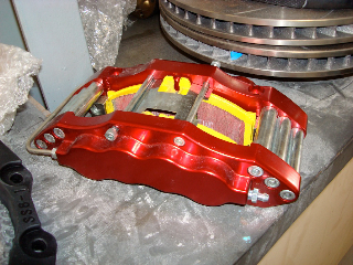

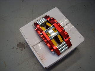

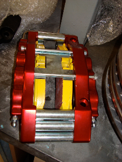

Some pics of the callipers I am using in my gallery if some one can upload them to here.:CRY:
Aussie Mike 03-14-2008 06:25 PM
Here you go. Very Bling, should look good on the car. :3DSMILE:

They are great looking calipers indeed.
But will they fit under a 15 inch wheel ?
