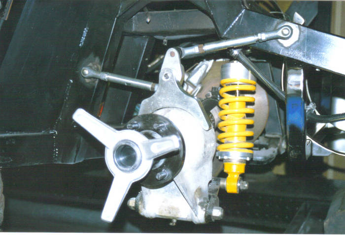

Hi Rob,
I wish I could post pictures like that, I always end up with postage stamp size, well done.
Question Rob, What are the things on top of the alloy carriers designed for.
Thanks,
Harry.
I'm guessing a Watts linkage to control fore and aft movement of the suspension upright.

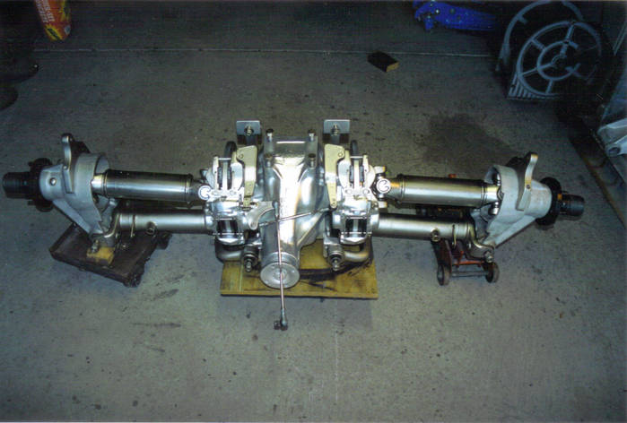

Posts: 1,495
YUP ! they're for a watts link set - up. I removed the brackets for trailing arms when I lowered the floor so I decided to fot the watts links to replace the arms. Got the set up from Cobracraft in Sydney. The whole thing bolts up if the wheels aren't too wide. My set up is traditional 9 1/2 x 15"

Posts: 1,495
Amazing I got the pic right. Idon't know how though ! It looks much better now that it's been cleaned up and painted.
