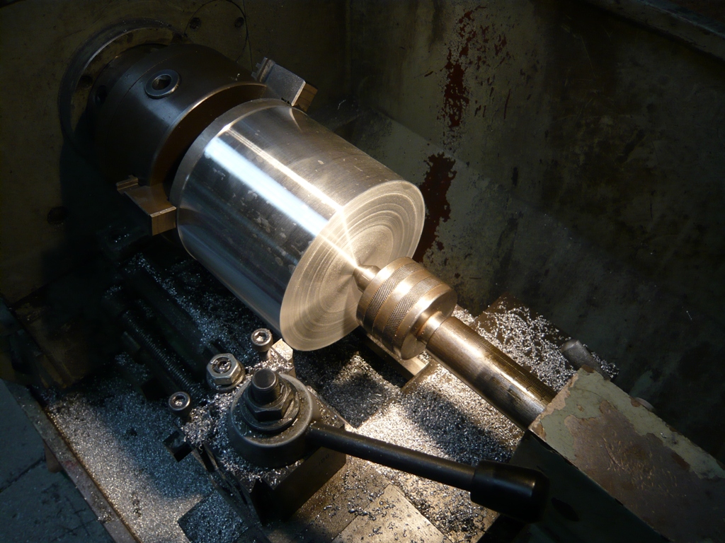

The billet piece is cut from a long length using a bandsaw and the ends aren't real square. The first step is to get it roughly lined up central using a dial indicator.
Here's the billet mounted in the lathe.

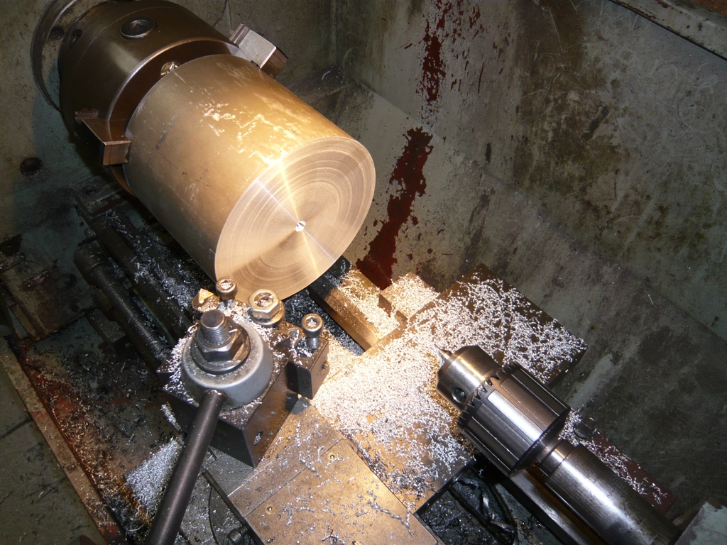

Once it's pretty close to square I machine the face square and drill a center hole using a center bit. This gives me a nice square face to mount the piece in the lathe. The center hole lets me support the end of the billet with a live center. That way it won't move around and will produce a more accurate piece.
http://www.clubcobra.com/photopost/data/500/Hub_02.jpg

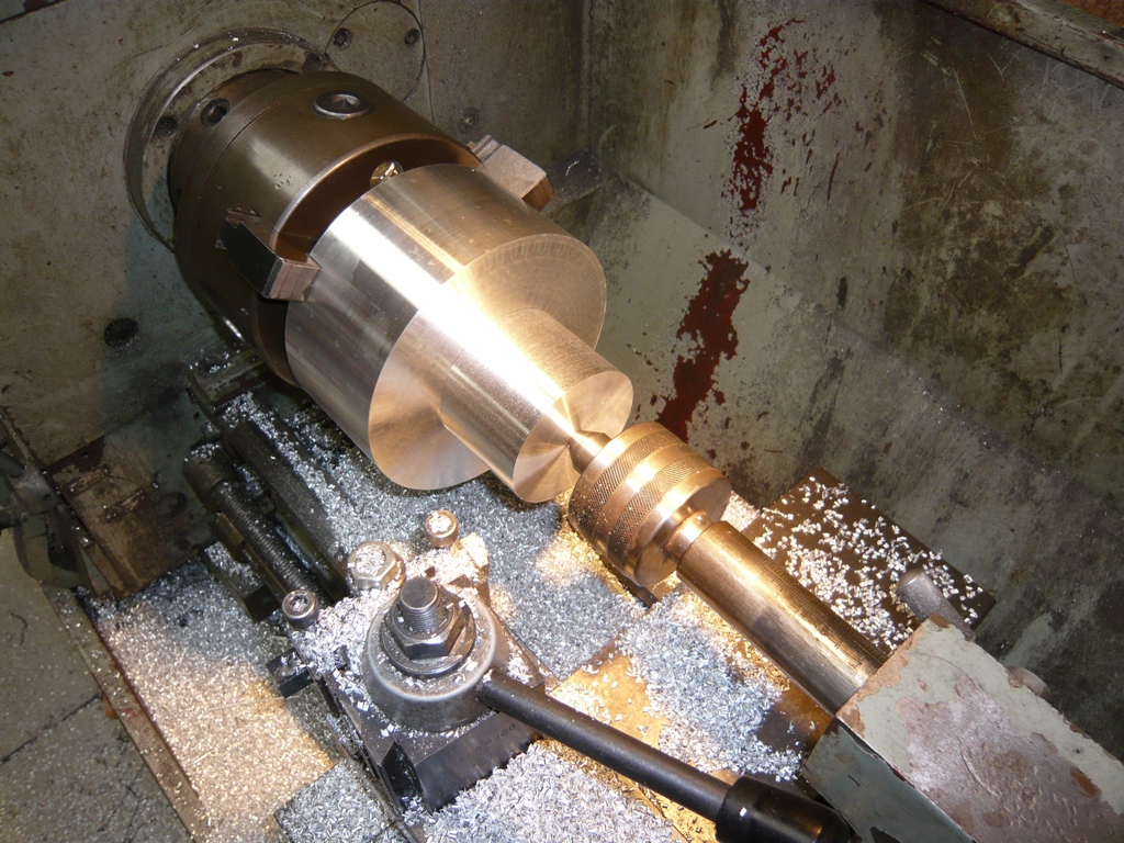

Here you can see the live center supporting the end of the billet. The live center has a ball race inside it that lets the work piece spin but holds it steady with pressure against the taper on the tip. The outside of the billet is machined down to the diameter I want for the outside of the hub. The smooth machined surface is also a lot more accurate for taking measurements from.
http://www.clubcobra.com/photopost/data/500/Hub_03.jpg

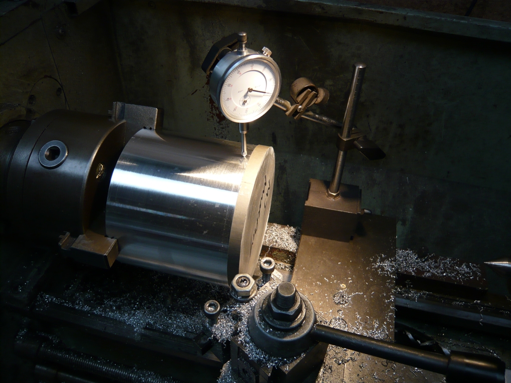

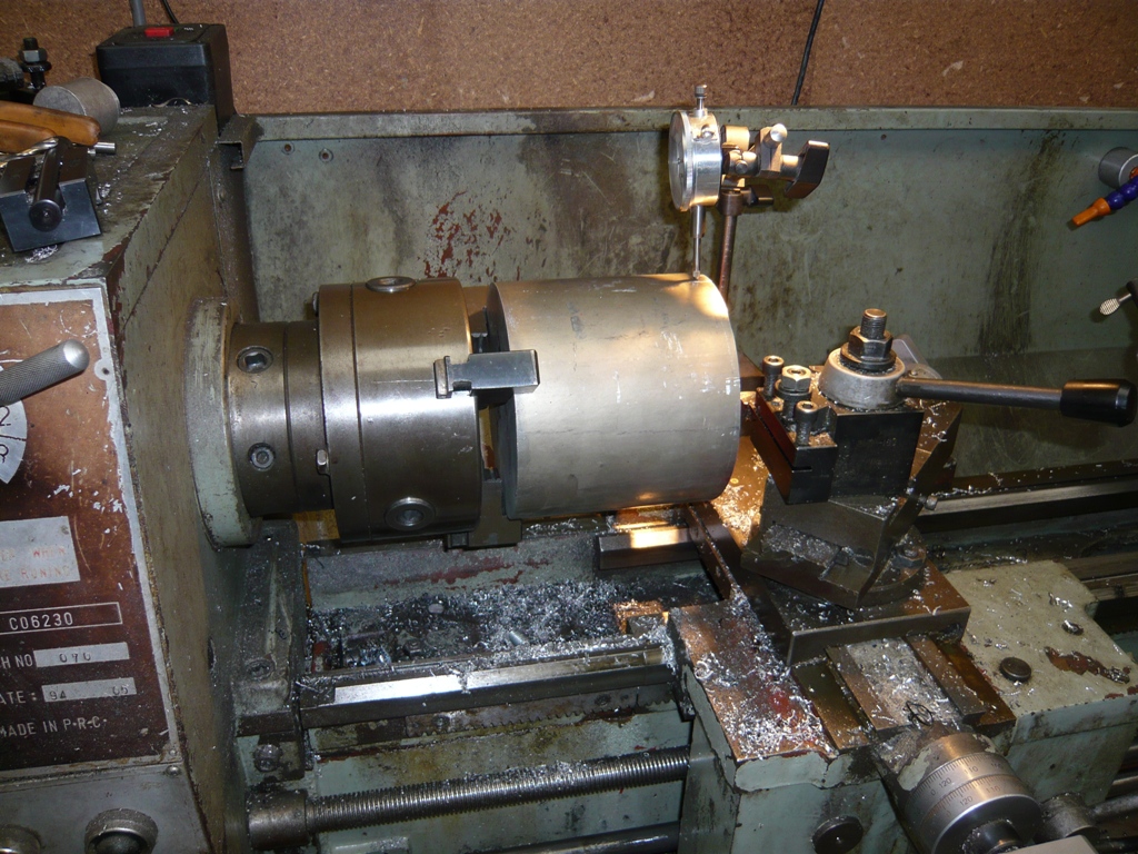

With the billet swapped around and mounted in the chuck against the machined face I check for runout with the dial indicator. This makes sure everything is square. I regularly recheck with the dial indicator especially if the piece is removed from the chuck and switched around.
http://www.clubcobra.com/photopost/data/500/Hub_04.jpg
I've machined the other face and added another center hole. You can see the tapered shoulder on the center drill bit that's designed to match the tip of the live center. Now I'm ready to turn a big lump of alloy into a big pile of swarf.
http://www.clubcobra.com/photopost/data/500/Hub_05.jpg

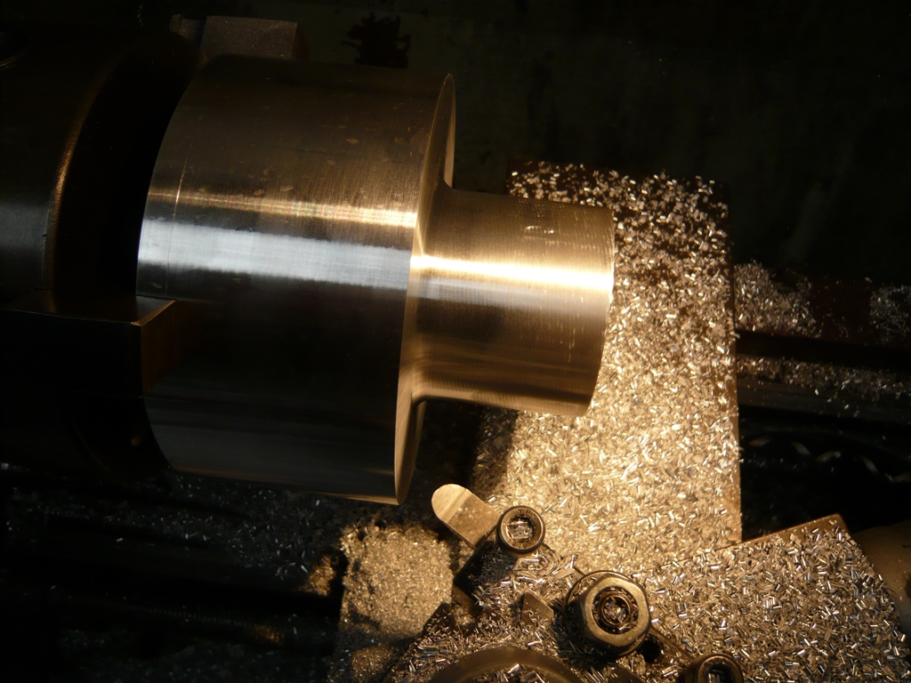

Here's the snout of the hub turned down. This is an important part of the hub as the snout or spiggot takes the load from the wheel. The OD of this is the same as the ID of the pin drive adaptor. It's a snug fit so there's no movement.
The other good thing about using a live center is that you can take a fairly big cut on each pass without fear of the workpiece grabbing the tool and getting pulled out of the chuck. You can quicly remove a lot of material.
http://www.clubcobra.com/photopost/data/500/Hub_06.jpg
The initial machining was done with an indexable tungsten carbide tipped tool. These things are great, each tip has 3 faces and they are pre ground to the righ profiles. They are also very hard so last a long while.
Some jobs requre a piece of tool steel ground to the right shape. I've ground this piece with a rounded end that lets me make a nice radius corner. The radius corner is a lot stronger than a square cut corner as it eliminates the stress riser in the root of the corner. Carroll Smith wrote a very interesting book called Engineer to Win. It has a lot of inforation about why parts fail and how to make them stronger.

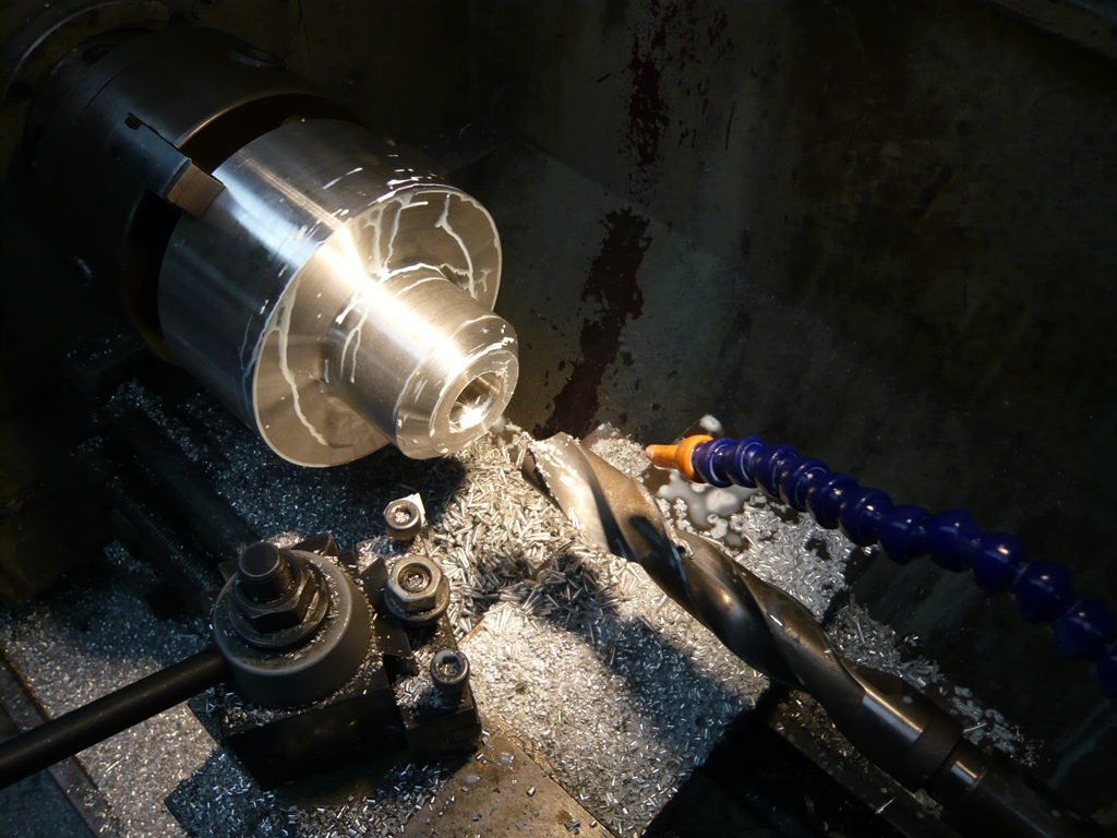

Next step is to machine the receses for the bearings. I run a big drill bit in to remove a heap of material quickly.
http://www.clubcobra.com/photopost/data/500/Hub_08.jpg

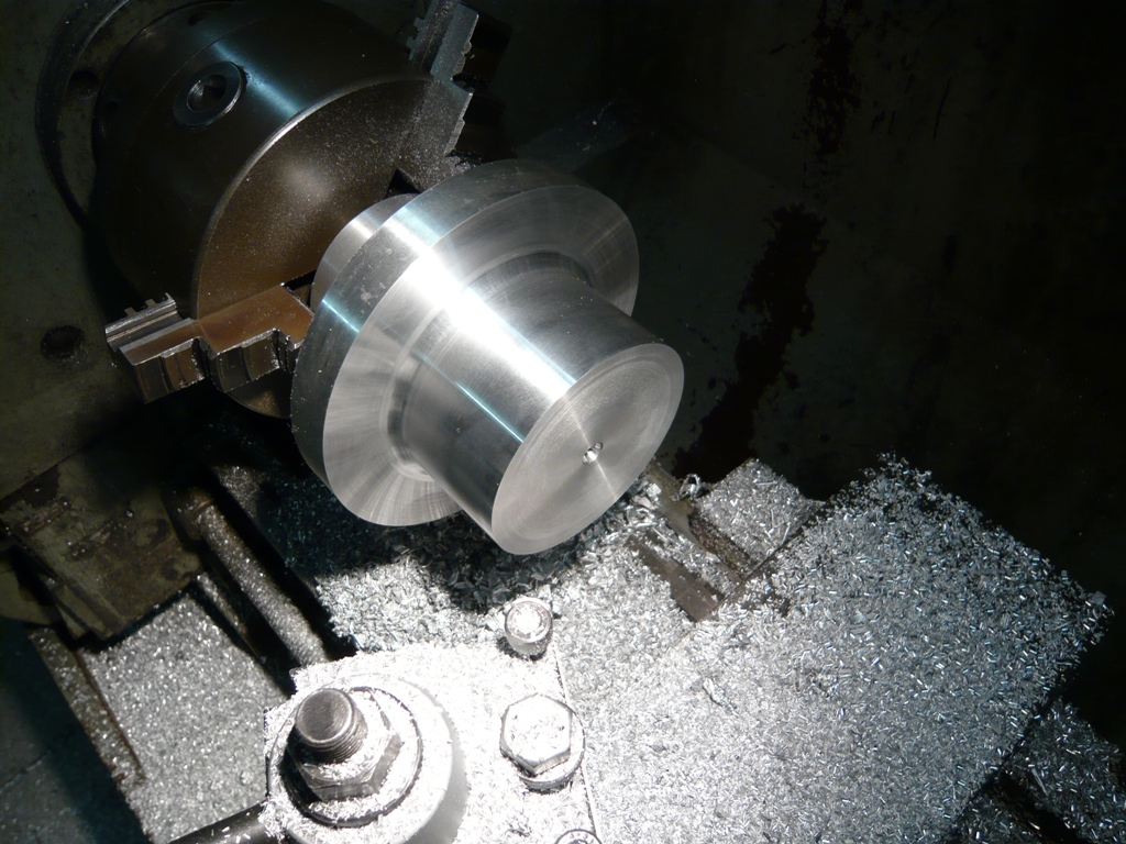

With all of the machining on the front of the hub finished it's time to switch to the back. The hub is flipped round in the chuck and checked again with the dial indicator. With the live center supporting I machine down the back of the hub. I've used the radius tool on the back as well.
http://www.clubcobra.com/photopost/data/500/Hub_10.jpg

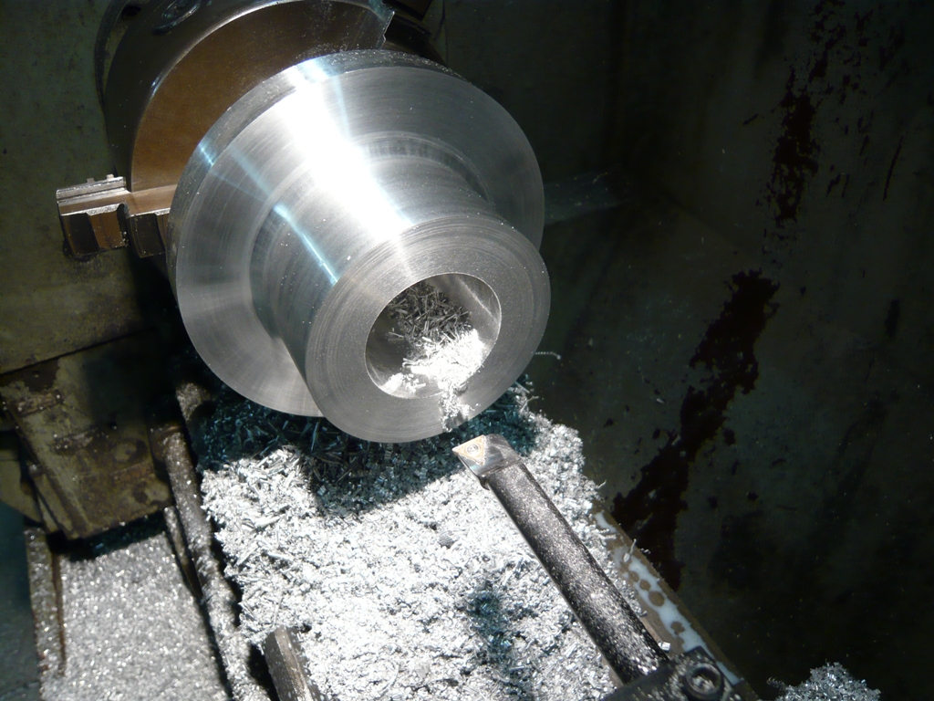

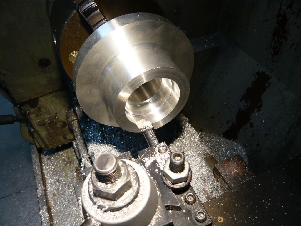

All that material in the center isn't provinding a lot of strength to the hub so it's bored out. Plenty of swarf on the lathe, time for a clean up.
http://www.clubcobra.com/photopost/data/500/Hub_11.jpg
More careful measuring and machining produces the bearing seats for the inner race and a seat for an oil seal to keep the grease in. I've also machined slight tapers leading into the recesses to help guide the bearing cup and seal into position.

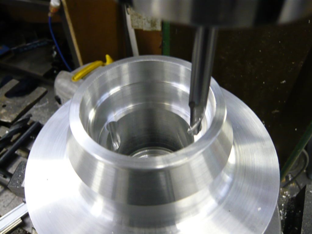

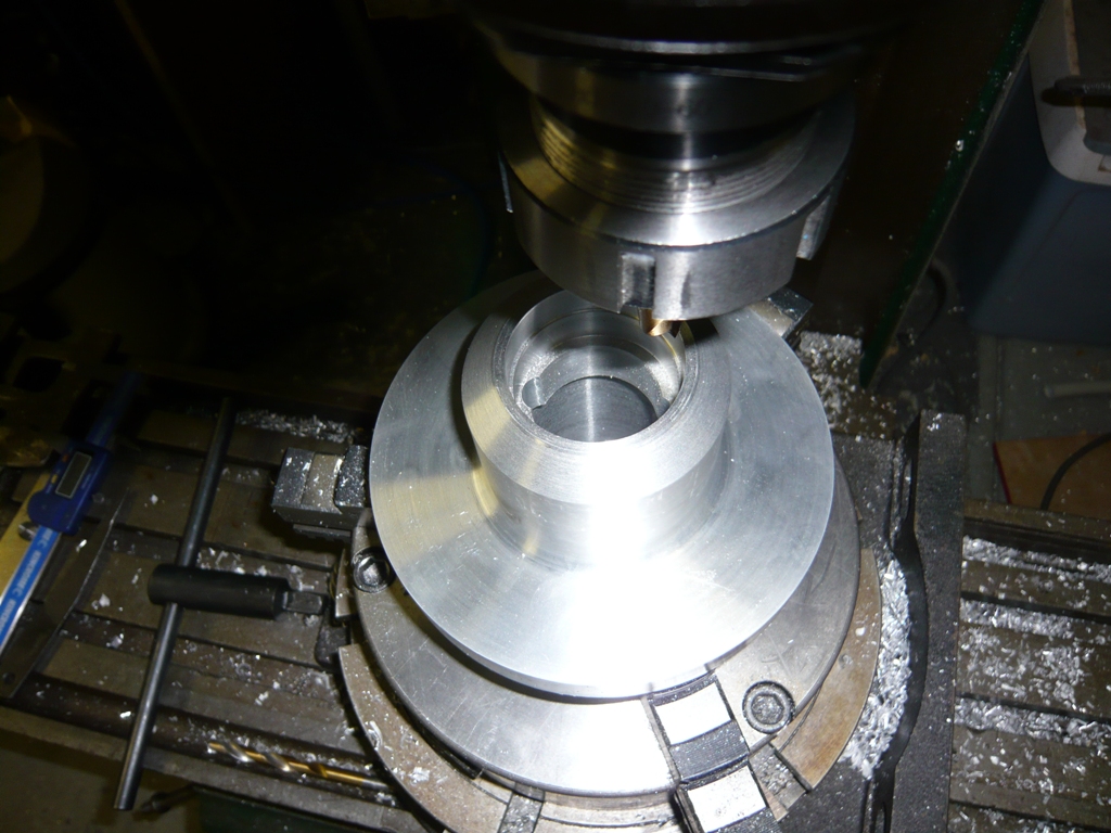

In order to make it easier to get the bearing shells out when they wear out I machine a couple of slots behind the bearings that lets me get a drift in behind the race to knock it out.
Here's the outer race.
http://www.clubcobra.com/photopost/data/500/Hub_12.jpg
And here's the inner race. I've used a ball nosed slot drilll so I don't produce any sharp corners at the bottom of the slot.
http://www.clubcobra.com/photopost/data/500/Hub_15.jpg

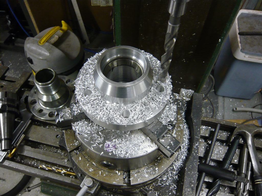

Now it's time to drill the Ford stud pattern. This was a tense moment as I've stuffed this bit up before. After checking and rechecking the PCD and runout on the rotary table I bored 5 holes in the hub.
http://www.clubcobra.com/photopost/data/500/Hub_17.jpg
With the holes in the right place I enlarge them to the right size for the wheel studs to press into. I also machine a recess for the head ot the wheel stud to slot into. This makes for a nice flush back to the wheel hub. I've made the face of the hub 20mm thick for strength. Aluminium isn't as strong as steel hub so I've beefed the hub up in places.
http://www.clubcobra.com/photopost/data/500/Hub_20.jpg
