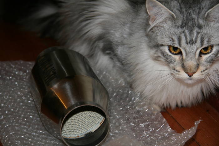

Les, the sump hasn't arrived yet but I have pics of the race cats. These are 100cpsi (cells per square inch) which means the honeycomb is 4 times as big as standard. I ordered 4" body with 2.5" pipe size so they're definitely going to flow nicely. The metal substrate is welded in place which I'm told will have more longevity than the ceramic cats from the factory.

BUMP - here's a picture of our resident quality control supervisor.

Hey Paul, Taa loads for the pic. The substrate being welded in is a huge plus.
