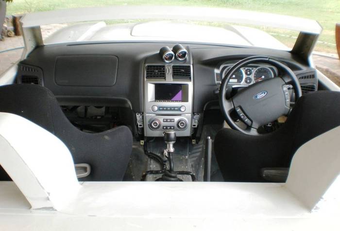

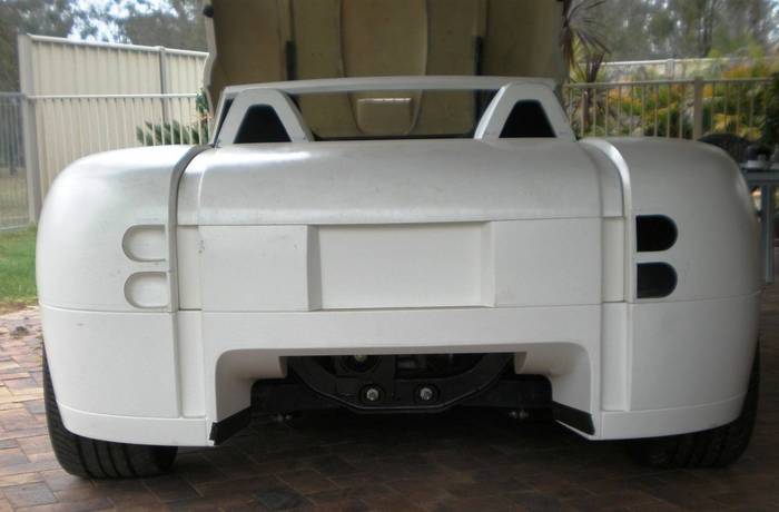

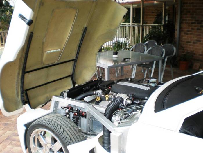

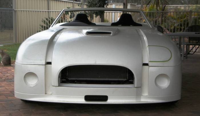

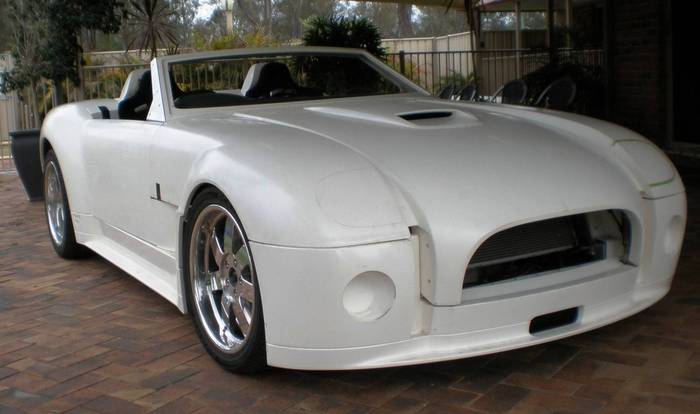

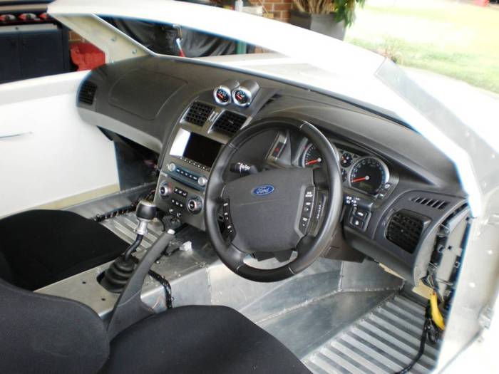

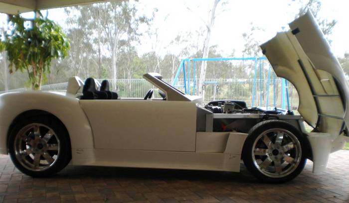

The car is now 100% mechanically finished, not much to go until it is ready for painting.
Engine started eventually(harness plug appeared to be at fault)and took it for a drive on Saturday.

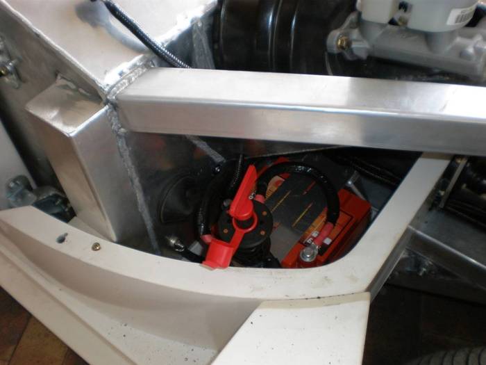

Fuel Tank
Battery
Warren

Hi Warren, very impressive build, love the fuel tank.
Mando

Looking good. It's hard to tell from the pics. Is there a significant structure inside the windscreen frame and under the roll over hoops?
It will be great to hear your driving impressions.
nice work, very neat.

Old 11-03-2008, 04:31 PM
jdean's Avatar
Join Date: Jul 2001
Location: Carrollton, TX
Posts: 1,735
Looking like a factory made car. What car did the dash come out of?

Cameron,
The side supports for the windscreen are made from 6mm aluminium to stiffen the windscreen frame and the hoops at the back are fibreglass with no other structure built in.
I only drove it a couple hundred metres up and down the road a few times with no mufflers and no doors. With power steering, a light clutch and smooth gear change from the falcon it did feel nice to drive. Sitting in front of a falcon dash and holding a falcon steering wheel the perception is it has a feel not unlike a falcon.
Jdean
The dash is from a locally made Ford Falcon. The kits uses a XR8 (a sportier V8 version) variant of the falcon for the doner car.
Warren

warren any chance of posting a few more photos on here.... curious to see what happens with the starter
