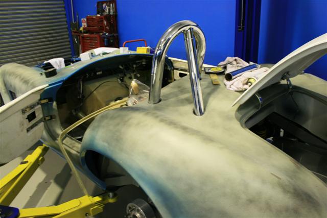

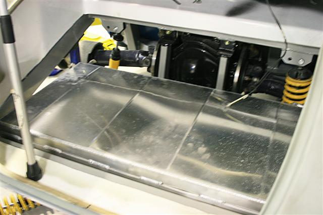

75 litre baffled aluminium fuel tank installed:
Twin 3" diameter Roll Bars installed.
Lights and blinkers installed.
Wiring Harness installed.
6 litre 307 kw V8 and 6L80E Tiptronic Trans going in next week after Comp Cam and Crane Dual Springs installed.
Pics on my Gallery.

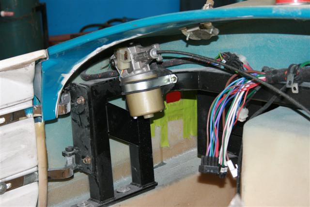

Thanks Mando. The fuel lines and Fuel Pressure Regulator went in today. We are working from the rear--- forward.

Good to see you having fun with your build bazzy...... roll bars don't look 3 inch

Barry have you sat the seats in front of the roll bars to see if the roll bar centre is in the centre of the head rest? the roll bars look very close together.....which means the seats must be close together
Old 12-17-2008, 07:48 PM
Baz's Avatar
Baz Baz is offline
Join Date: Jul 2007
Posts: 1,400
Thanks for your interest AC460. My mistake. The roll bars are actually 2.5" diameter with 2" rear stays. I originally ordered 3" from RMC, but have now established that they can't successfully bend the 3" tube without it kinking severely. 2.5" were as thick as I could get and I'm really happy with them. The seats positions have been checked and fit in with the roll bar centres perfectly.I will be posting some more photos shortly.

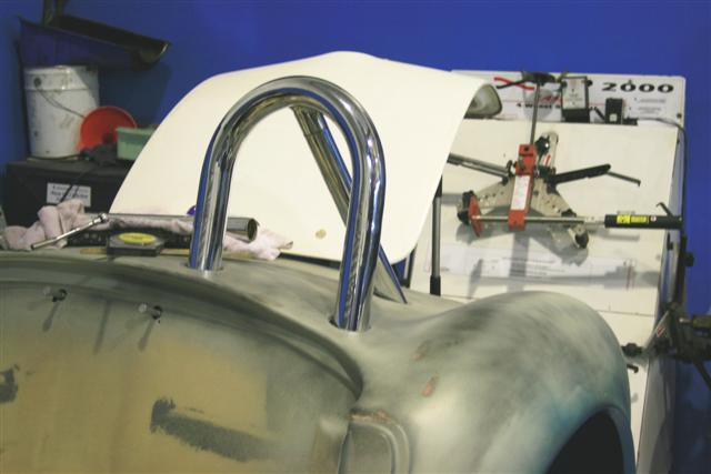

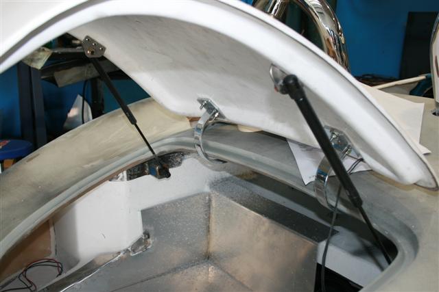

A helpful hint for anyone installing Roll Bar Rear Stays. After the hoops have been positioned, secure a torch inside a section of rubber hose and push that hose up onto the point where the Rear Stay joins onto the Roll Bar Hoop. The light from the torch indicates the exact point where the holes are to be cut through the body for the Rear Stays to be attached to the chassis. You can see this better in the above photo.

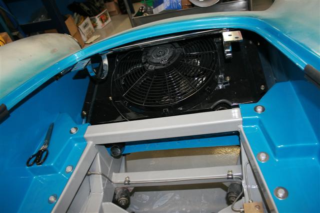

Old 12-17-2008, 08:13 PM
Baz's Avatar
Baz Baz is offline
Join Date: Jul 2007
Posts: 1,400
Default Its Been A Busy Week.
The radiator and cowling in position.
