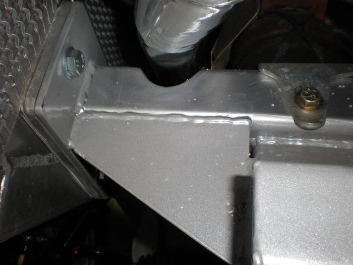

I have been asked a few questions about the build lately. Like the old saying saids a pictures is worth a thousand words.
The starter motor is accessed through the passenger side footwell
The fibreglass starter motor cover
Modified crossmember
Repositioned O2 sensor
The above pictures of the headers are mods that is required to aftermarket headers(Pacemakers) to fit them in. The Pacemaker headers are around half the price of custom made headers.

I removed the sensor socket and blanked off the hole. The centre of new hole was about 15mm from the centre of the existing hole towards the centre of the car. If they are moved too far around the length(or lack of) of the sensor cable could be an issue.
If you look at the chassis rail offset you will see the front rails line up with the front suspension mounting points and the rear ones line up with the rear suspension frame mounting points.
