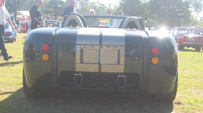

I am trying to source a reverse light for the 540 that doesn't look like a tacky after thought. I am looking to try to integrate it into the rear of the car with a modern look. It has to have ADR approval as a reverse light.
Heres the back of car any ideas.
Also trying to find a high brake light to integrate into the boot as well. The light will have to have a similar curve to the boot and clip in from the outside. The latest model Subaru Imprezza Hatch looks as though it could be the one, but this car is so new the dealers have no listing for any of the car in spare parts.
Warren

What about designing a licence plate light(s) that double up as reversing lights?
With the 540 I could imagine 2 rectangular short strip lights fitting vertically in that angular recess directly either side of where the licence plate will go...The strip light could have two strips of LEDs or 2 globes each connected to the licence plate light (facing each other) and reversing light (facing to the rear of the car) functions.
An alternative could be a single strip light made the same length as a licence plate sitting horizontally in that angular recess directly under or above where the licence plate will go?

A temporary one on a bracket underneath then wire to the turn lights later?

Thanks for the suggestions so far.
Paul
The difficult part is trying to find a lamp that will fit and is ADR compliant. The angle around the number is about 45 degrees so it might to much of angle to be allowable.
Merv
I have seen the Subaru lights and thought they look pretty good. I would rather have only one light, the shape of this light would need 2. These lights are on my maybe list if I decide to use 2.
Mando,
To fit the 3rd brake light in boot I would form a recess (along the shadow line on the boot in the picture above) and find a light that has approx the same curve as the boot. Subaru Imprezza, Holden Vectra, Mazda 3 and Mitsubishi 380 all have lights that suit. The Holden and Subaru light clip in from the outside which is preferable.
Tenrocca
Have had this thought about a temp reverse light for rego, but the vehicle needs to painted for rego, so if I decide on a light that needs to have a recess cut into the panel it needs to done before it is painted.
I can use a Hella 3rd stop like on the AC Cobras, but I am trying to find something that is more with modern era of the vehicle.
Hella make a clear LED light the same as the red LED 3rd stop light which would work well for a reverse light, but the clear light has no ADR approval.
Warren
