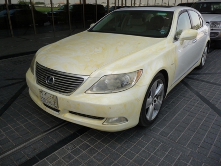

Krait 06-03-2009 03:12 AM
Hi,
The Saudi's have a more down to earth approach to the paint protection problem caused by sand. Perhaps it could be coloured to match.
http://www.clubcobra.com/photopost/d...udi_mask11.JPG
http://www.clubcobra.com/photopost/d...udi_mask21.JPG
