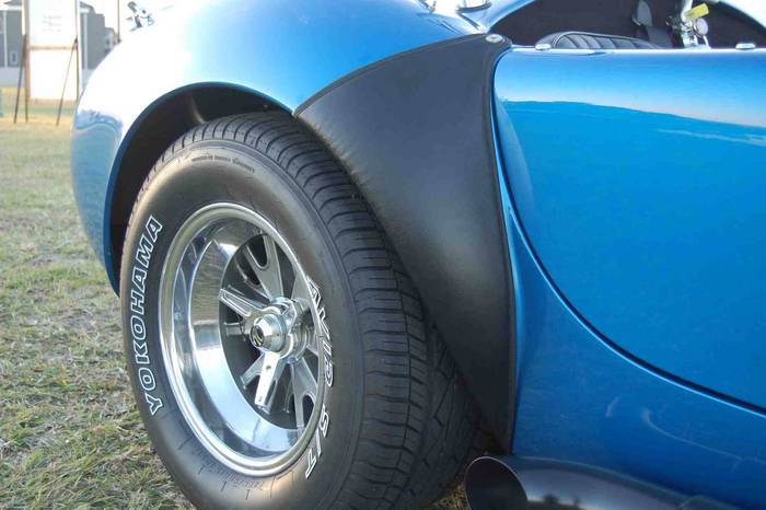

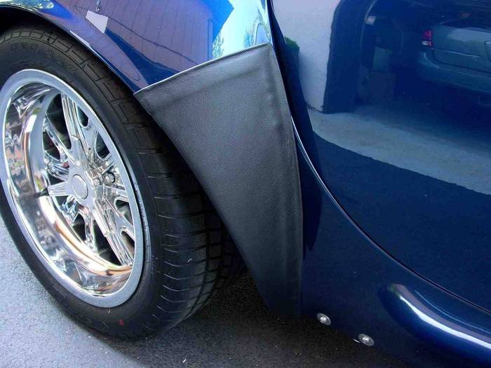

For those of you interested in removable 'spats' instead of the usual chrome/metal fender guards ... these are interesting. The first, courtesy of Craig White. They could obviously be in any colour.
Both are attached under the edge of the guard by velcro and at top an bottom by "lift-a-dot" or similar means, and this site gives a good description of the attachment process (plus some high quality pics of all kinds of build processes if you want to explore):

They do look similar - but wonder if they would fit our Cobras? I am ignoring Rebel 1's tasteless comment about Craig's taste in swimwear....

I was really pleased with the leather splats. If you are going for a classic/vintage look, then they are a great alternative.
I would highly recommend getting them custom made so that they fit your guard shape and soft top mount location perfectly.
Mine had a thin foam backing and edged. Attached to soft top mount at the top, used a short strap with press stud to attach bottom to the chassis. Then just velcro to attach inside the wheel arch.
They are also really suitable if you want to retrofit as they are great for covering up existing stone chips & marks.
Just pop them off when you are washing the Cobra.

Thanks Craig. Yours were so good and practical that I decided to go for a similar pattern. They are being custom made in a close-to-body-colour backed vinyl and fitted as yours have been using 3M industrial type velcro. They should be easy to remove for washing and still be 'old school'.
