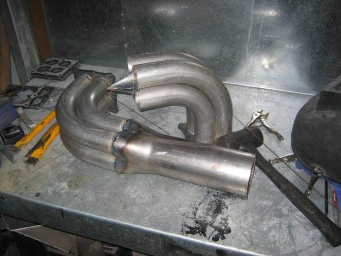

Is a flush fit a simple as trying to find a combination of bends that have a difference in the centre line radius, the same as the tube diameter that I am using.
For example - Centre Line Radius of 56mm and 100mm gives me a 44mm difference.
The diameter of 1.75 inch pipe is 44.45mm so it should be almost perfect.
Am I missing something, just want to make sure before I buy a stack of mandrel bends that look crappy.

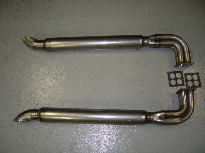

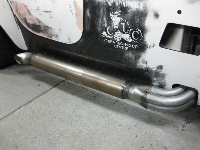

I usually use 4" and 6" CLR or 3" and 5" CLR bends depending on what I can get. The new set of pipes I've built are 4 and 6. I use 2" tube so the 2" difference in the Center Line Radius means they snug up next to each other perfect.
You basically want the difference in the CLR to be as close to the diameter of the tube as possible for a neat stack.
The problem you are going to find is locating a supplier that has dies in the CLR you want. Most are going to be round numbers like 3" 4" 6" CLR etc
I reckon a CLR of 2" and 4" won't look real good. Wider radius bend look better in my opinion.
There are 2" tube with 4" and 6" CLR
These are 3" and 5" CLR in 2" tube
