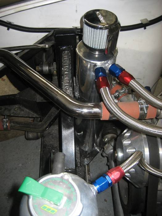

Hi Dave,
Pretty easy to make your own. I built one out of 100mm diameter ally tube.
This one has 2x #10 fittings on the top. There is a baffle inside that forces the air/oil vapour down the side of the tank and out through a perforated section. This helps separate the oil out before the air goes up and out through the filtered breather at the top.
This one holds about 3L or so. I've got an #6 fitting on the bottom that has a cap on it for a drain but I'm setting it up to run back ito the sump via a 1 way check valve.
I've made a coolant catch tank in the same style and removed my old header tank. Preciously at track days I had a soft drink bottle taped to the front X member for a coolant catch bottle (10 out of 10 for rat rod style). I've machined up and welded a filler neck direct to the water pump and the pressure cap is on there now. The coolant catch tank is set up with the inlet/outlet at the bottom so coolant will suction back to the motor as it cools. The coolant crossover between the heads also burps to the top of the filler neck as the highest point in the cooling system. The system fills really easy.
Hopefully the whole setup looks more racey than ricey
Mike Murphy
Melbourne Australia

Plumbing back into the sump - aren't you worried about condensation getting into your oil? I've seen milky white stuff in the bottom of those things.
Old 05-21-2009, 10:55 PM
Aussie Mike's Avatar
Location: Sunbury, VIC
I don't think condensation will be a problem. With the check valve the oil will drain straight back to the sump while it's still hot and not have time to build up any condensation. After running a while the catch can will get pretty hot and cook off any condensation while driving.
Mike Murphy
Melbourne Australia

That is really pro looking, Mike! I like it better than the $200 can.

When you're running a mighty Chev you gotta do it justice.

Very nice Mike......How much for both catch tanks??
Old 05-22-2009, 07:15 AM
Sorry Dave, I'm just supplying ideas not parts at the moment. Too busy trying to get my own car finished.
Mike Murphy
Melbourne Australia

Beautiful work. I like seeing a nice tig weld and looks racey too.
The custom intake with the hoses to the tank is very nice also.
