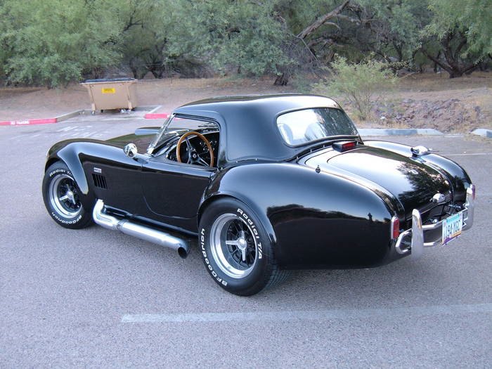

Merv, I am sure almost any can be adapted. Needless to say, the bodies are all a little different (windshield rake, etc.). This top attaches with two clips on the windshield and two clamps behind the seat. It seals against the body with a rubber gasket.
The top shown is mine being fitted on another Butler at Ron Butler's place. I will be painting mine black to match my car. I am told to put some diatomaceous earth in the paint and the result will be dulled, flat and have a fabric like finish....sort of like texturing a wall.
Anyway, good luck.

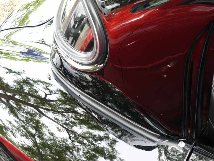

The photo below is my hardtop. It was built by Homebush Fibreglass to suit the extended Harrison. Since then there has been modifications to ensure it fits correctly. The underneath has been coated with a resin and microscopic balls(can't remember the correct name for them) mixture to thickness of about 2mm thick to act as an insulation.
The back window is what Homebsh fits. If you are going to build one and fit a rear window like the SPF I think there is someone in the club with a mould to manufacture this type of window.

The front is a channel with a rubber moulding that fits very snug over the windscreen top edge. The rear has a large soft rubber seal (about 1" thick) that sits on the rear sill. I used a clear 3M tape to prevent marking the paint and after years it's still good. The top is very closely contoured to the body.
One note. Hardtops are NOT quieter, in fact it's louder than having the top off. You get the sound both captured in the cabin and transmitted though the top like a speaker. but for long distance driving and when the rain is coming down, it's brilliant.
