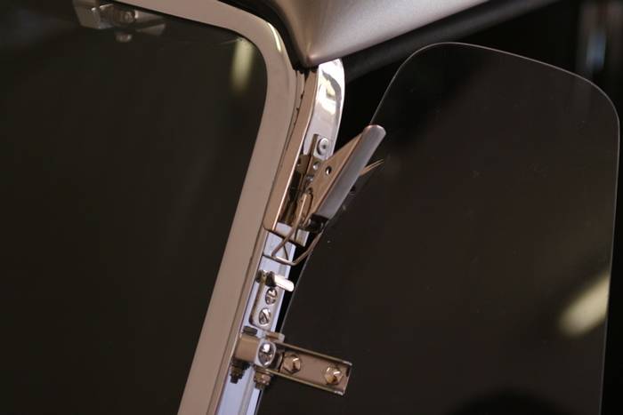

Old 06-14-2009, 11:23 PM
Cameron Parsons's Avatar
Join Date: Nov 2003
Posts: 768
Default Hardtop and fittings
Here are some photo's for you... I hope this is useful.
Hardtop on for last years Nationals..
Profile
Rear 3/4 view
Tension Clips at windscreen edges
Another view showing the angle and leading lip of the hardtop, this sits over the screen top.
the top is secured by the two clips at the front and two through bolts on each side at the rear door post.

Old 06-16-2009, 07:16 PM
Merv and Sharon's Avatar
Posts: 3,482
Many thanks Cameron - these are extremely useful.
I am, however, confused about where to go with this. A hardtop for the Harrison 'could' (it seems) be adapted from the CR version (if available?) but a good deal of work would be needed to fabricate it, front and rear. It would also need to be lined internally. Also, it is best to do these things BEFORE painting I gather, to avoid scratching. Further, the hard top has limitations in use, storage and removal. I had one before on an MGA and a Merc SL. Great if you are going to leave it on for sustained periods.
