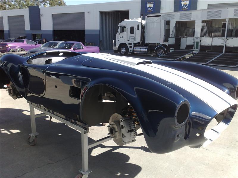

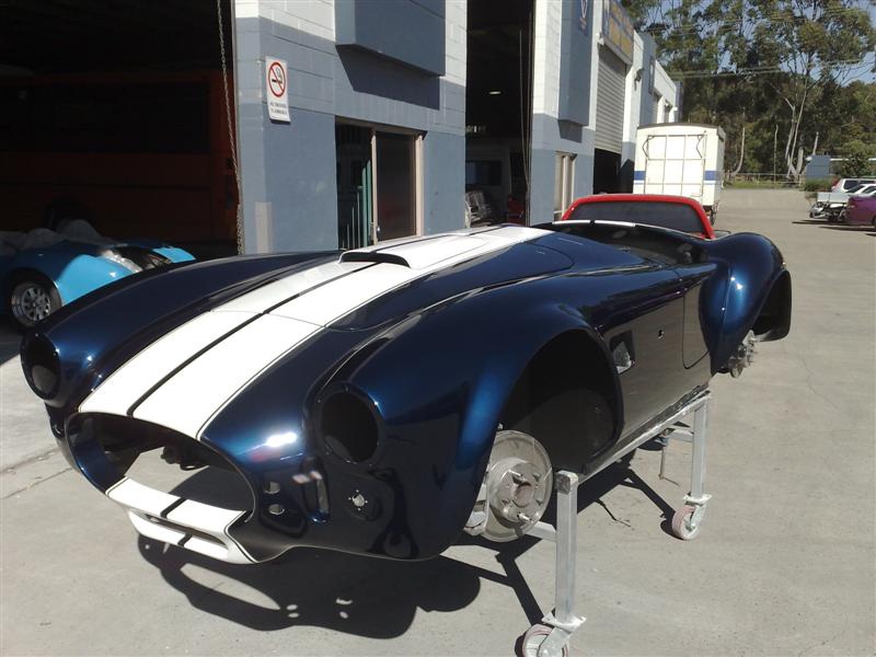

Picked it up this week after 5 weeks at the painter,
Colour is Dark Blue Mica with white stripes
Now to put it all back together

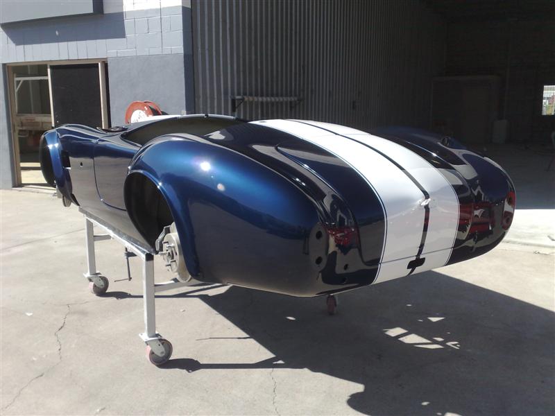

Yes Merv - I think it was good value. I was impressed with the stripes. They all ended up at the same level and not overlaid.

Looks brilliant. Whats the hole in the drivers side front guard for? Did you taper the stripes or are they a constant width?

Mando - The hole is a removable panel to allow access to the master cylinder and booster. Stripes are constant width.

Looking at your photo's you might want to check your disc rotors orientation. The slots should taper to the rear (Discs are normally marked SL and SR). Refer DBA Australia link http://www.dba.com.au/2006/QnA/DBA_QnA_22.asp. Some of the newer slotted discs it doesn't matter but on these I believe it does to remove the dust and gases correctly.

Did you add pearl to the white???

No pearl in the stripes. Just plain white.
