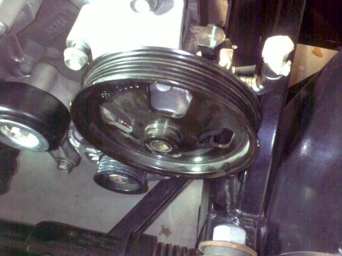

Hit a couple of snags tonight when fitting the VE p/steering and alternator to my L98 and hoping some Harrison owners have solved these problems.
- Power steering pulley fouls on the chassis rail that runs down diagonally from the top of the footbox to the suspension upright.

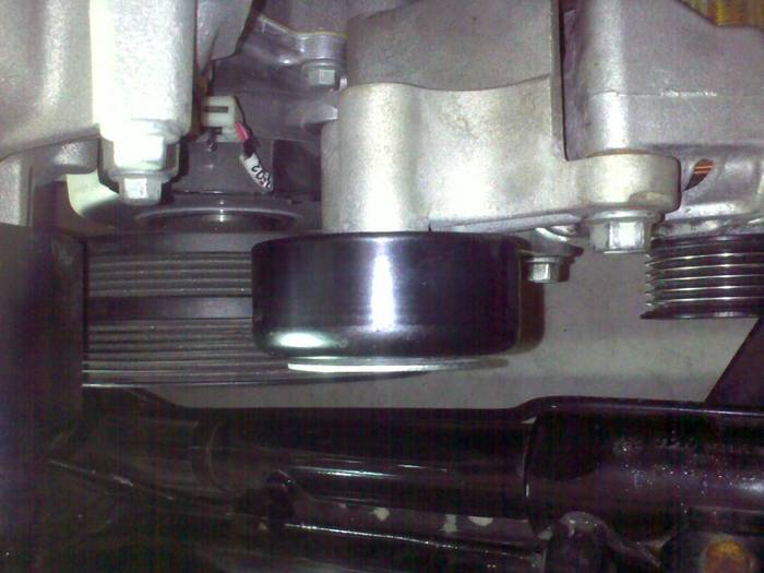

- Alternator goes in fine but the pulley (nose) is out of line with the harmonic balancer. It's about half way between the 4 grooves for the aircon belt and the 6 grooves for the serpentine belt, which is the belt it should line up with.

Balancer hitting rail:
http://www.clubcobra.com/photopost/d...2072009401.jpg
Misaligned balancer, idler and alternator (from left to right):
http://www.clubcobra.com/photopost/d...2072009406.jpg

Thanks Schipps and Slowy. Yes I think a custom bracket is in order. Alternator still has me confused. Can anyone chime in with a photo from above to show the alignment on their L76 / L98 / LS2?

By how much does the PS pulley foul the side rail Sambo?
sambo 07-22-2009 06:48 PM
Mate I reckon 5-10mm but I'd need to allow more for the engine to torque up. Do they lean to the drivers or the passenger side more when revved hard? Opposite to crank direction I assume.

Mate, I'm not familiar with the Harrison chassis but you may have to consider moving the Centerline of engine to the right of centerline of chassis a little.
This in itself will give you a better alignment to your diff pinion flange anyways.
Then you may also consider raising the engine height a little ... say 6mm ... by putting a 6mm shim/washer under an engine mount.
Just a couple of things to consider before you start knotching that rail.

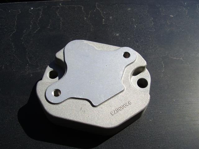

Or you may get a new PS mount milled with the pump closer to the engine. The L76 PS mount is 23mm thick with 4 holes ... just have the two pump holes (the threaded ones) moved closer to centerline of the engine.
http://www.clubcobra.com/photopost/d...unt_Small_.jpg
