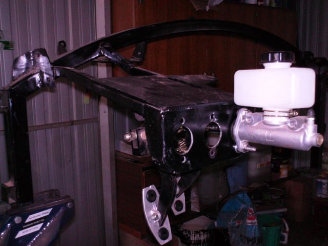

Does anyone know of an adhesive I could use to stick the standard aluminum pedals you find on cobra's onto the steel plates on my arms? I have ground the lug from the back of the pedal so it's one thickness all the way, and I intend grinding of the paint from the arms.

Hi there Mando, I did not use glue when attaching mine.
I cut the metal pedal pads off and fitted the pivoting AC pedals, although not finished in the attached pics, I later fitted a longer bolt through the pedal and fitted a coiled spring that pushes between the upper part of pedal and the arm.
Sadly I do not have a pic of it.
But I think Aussie Mike did something similar.

DO NOT use any sort of adhesive for this. It is a safety item that is too important to risk a bonding failure. DON'T DO IT. Attach with countersunk machine screws or better yet as the photos illustrate.

I also would advise against using glue. If you don't want to use a pivot setup then I would drill the backs of the pedals and rivet them to the steel plate. Alternatively you could drill and tap them from the back.
The last thing you want is your pedal tread coming loose when you jump on the brake.
Here's a pic of the spring loaded setup I did.
The idea is that the pedal tread can pivot under the ball of your foot and keep it flat. With the low seating position in relation to the pedals the clutch pedal can get to an uncomfortable angle at the end of its throw. The pivoting treads fix this. I wanted the treads to pivot freely but sit level and not rattle when relaxed so I spring loaded them.
They are comfee to use and have good feel.

Rick, your absolutely right, I'll glue them for now and get some screws into the back of them when the cars off getting painted.

Boxhead, Mike, I really like the idea of the pedals pivoting. If I go down that route now I'll need to extend the length of the arms before attaching pedals. As I said in my last post it may be a job I'll tackle when the cars at the painter.

If that question is directed at me Merv, I'd have to say probably not. Screws through the rear into the aluminum should make them a lot stronger.
