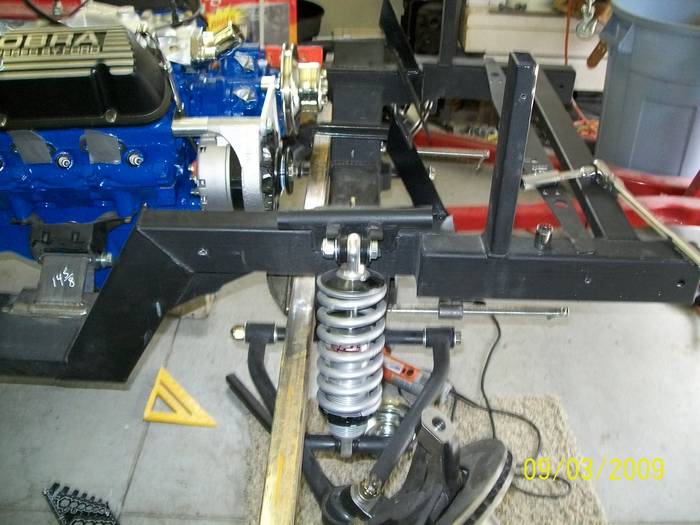

It is very hard to measure the wheel base accuratly from the spindles. Notice the bar that is clamped to the K member below. The center of the K member is the center of your spindles. Hold you tape over the bar equal to 1/2 the thicknes of the K member and then measure back 90" for the center of the axles to see where you are. There is a machined edge you may want to measure to after doing the math deductions. It's easier to measure to than trying the eyeball the center of the axle flange. Also in my gallery is a picture of my four link with heim joints.

Ok, first off, loosen all 8 bolts on all 4 control arms. Unbolt shocks. raise the axle to ride height (lower control arms are level). Retighten all 8 bolts. Sometimes that's all it takes to center it. When I install the body, I measure to center it off the axle, not the frame. Don't measure off the spindle. They move. If you loosen one of the upper control arm bolts and move the arm or turn the steering wheel 10 degrees either way, your measurements will go crazy. Wayne was correct by measureing off the k-member. I use a 6 foot long, 3/4 inch angle iron (perfectly straight) across the back of the k-member. Between the frame and front lower control arm. That should be roughly 88".
