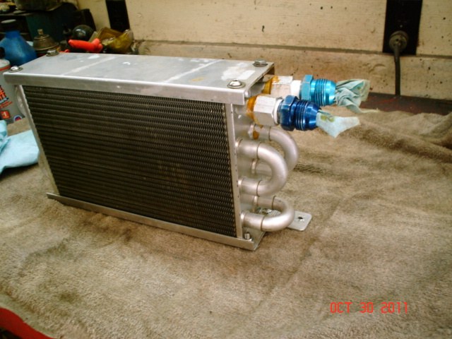

These are the oil coolers I've tried and the results. The car is a 65 Mustang road race car with a 331 cu in stroker, making about 500 hp, running 15/50 Mobil 1 synthetic oil. My normal rpm range while on track is from 3000 to 7000 rpms......
[IMG]url=http://www.clubcobra.com/photopost/showphoto.php/photo/77843]  [/url][/IMG]
This is a "headered" engine oil cooler, it is the least effective,but does offer great flow thru the cooler becasue of the bigger tubes, problem is, the oil flows too fast thru the cooler to cool it down to any degree..I have a temp gauge in the oil pan and one coming out of the cooler as it goes to the filter,giving a reading of the "cooled" oil before it goes back into the engine. This particular cooler would start out with about a 15 degree difference,during the course of a 30 minute race, that difference would drop to about a 5 degree difference!!!!!!!

Then I switched to this engine oil cooler:
this is the same type used in NASCAR,in fact I bought it used from a NASCAR team.... Almost identical to your average transmission oil cooler... It worked better than the two above, but still not good enough for my application, it was just too small in size.....
Then I saw this one:
[IMG][url=http://www.clubcobra.com/photopost/showphoto.php/photo/77840]
It's off a 2010 Ford F-150 Super Crew truck,it's the trans. oil cooler,it was free, so I tried it and guess what,it works... It is exactly twice the size in square inches as the NASCAR cooler and has the same size inlet/outlet and almost identical size "plates".....
with this cooler I now have a 20 to 25 degree difference in oil temp, which I needed as I have run oil temps of 250 to 270 degrees with the other coolers. Now my oil temp stays in the 210 to 225 range!!!!!!
With this cooler I have about 8 psi less oil pressure across the rpm range than without any cooler.....
here is a pic of the two coolers side by side for size comparison....
