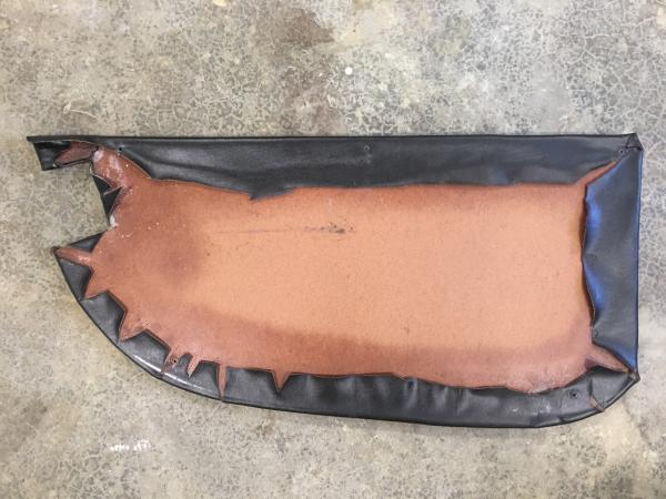

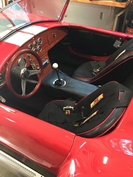

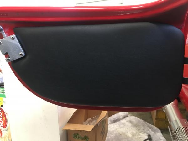

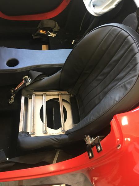

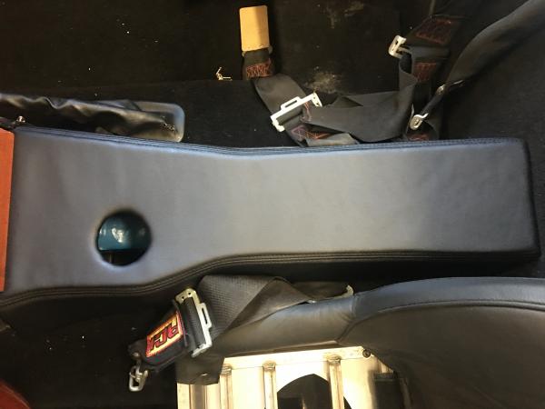

Finally got around to installing new FFR seats in my B&B. I bought the Breeze mount and couldn't be happier. I Have not finished but here's the driver side.
There is a before, interior picture and the most recent. New center console and new door panels. I made the center console and door panels. I had them upholstered.
joyridin', navyeod and spdbrake like this.
