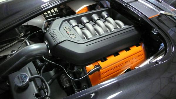

Picture below:
The Coyote in a Cobra is an impressive package. Very clean install and enough power to make your head spin.
We did leave room for expansion just in case and the car is set up to add a supercharger at a later date.
