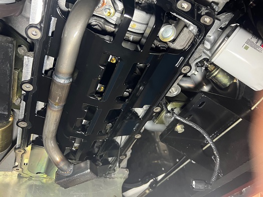

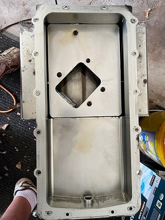

tims210 07-18-2022 09:43 AM
I pulled the pan to inspect the baffle to see if I had the old style or the revision. It seems I have the old. Moroso is sending me the revised baffle. I attached pictures of mine and the revision for those who are curious. The first is mine and the revision is second. You'll notice the oval relief hole so it allows the dipstick to seat fully. The third shows how my dipstick scraped the pan causing the stick to arc and give a false reading. I also found that I do have a windage tray (last photo). It's a Moroso product that is required when installing their pan. now that I have the pan off I can experiment by pouring water until it comes to the bottom of the baffle and then count additional quarts for filter, oil in suspension, etc. By looking down the baffle I can't see how more than a few quarts can fit in there to not exceed the baffle height. Using eschaider's previous calculations, plus another 1/2 qt. for the Motorcraft filter, that would put me at around 5 quarts total. Doesn't add up. Maybe that baffle area holds more than the eye can see. I'll try and see what happens. Does the windage tray throw off any of the mentioned calculations?

eschaider 07-18-2022 01:38 PM
That is the OEM Ford Coyote windage tray. The basic tray design is quite good and allows the use of the OEM oil pump and pickup. Even better, it looks like it will work nicely with the Moroso pan.
The sump might hold more than it looks like so be sure to test. Low profile pans with side sump expansions can be deceivingly larger than they appear. Also make a hole in the baffling for the dipstick. The windage tray will not affect pan capacity.
tims210 07-18-2022 03:22 PM
Interesting. I didn't know that these engines came with their own OEM windage trays. I misread Moroso's website. It seems they say THEIR windage tray is required for gen 3 engines and is only a replacement option for gen 1 & 2's. My mistake. I mentioned that they are sending me a replacement baffle with the relief hole. Moroso still insists that a level being over the top of the baffle is fine. Hopefully my test measurements equate to the proper OEM readings on the stick. Makes life easier. I know I'm being overly anal here but, like anyone, I don't want to be over or under oiled. We all know the consequences.

eschaider 07-19-2022 12:08 AM
When you have that particular windage tray between the crank and the pan, it goes a long way to help in limiting the amount of oil the crank can whip up from the pan. if your six or seven quart fill takes you a bit over the baffle in the pan it probably doesn't matter much. When the engine is running, that black plastic windage does a pretty good job of protecting the oil in the pan.
