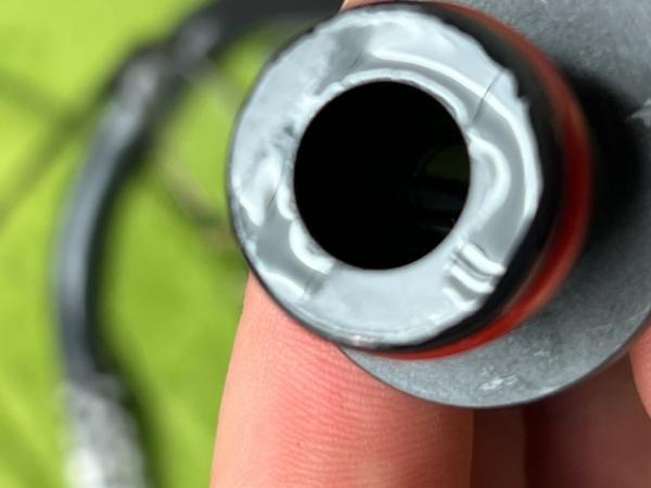

I decided to tinker around more today. I pulled the PCV valve, vapor hose and the fitting at the intake that the hose clicks into. I noticed quite a bit of oil at the intake fitting. Unless this is normal, I'm concerned. The PCV valve clicks back and forth when I shake it. From past experience that would be normal operation? If something is wrong, please let me know how to proceed. Thanks.

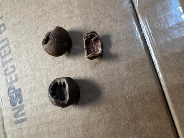

Forgot to mention something. I didn't realize there was a cavity at the front of the motor that gave access to the underside of the intake manifold. A rodent must have gotten in there to store some reserves for the winter. See photo. I snaked an inspection camera in there and discovered them. They could have been rattling against the knock sensors leading to unneeded timing adjustments by the PCM. I tied a small flexible hose to the camera arm, then to my shop vac, and surgically removed them. I should have gone to med school.

The nut shells don't have enough mass to affect a knock sensor, and if they did the VCT won't split out on one bank. Would be Pi$$ poor design to have the engine have one bank producing more power and firing out of time.
The PCV oil is pretty normal and can be eliminated by adding a catch can. Usually needed as rings have more blow-by via age or Super/Turbo charging.

The oil is not enough to worry about and a catch can will only make the catch can manufacturer richer and add no value except give you one more thing to look at and fret about.
