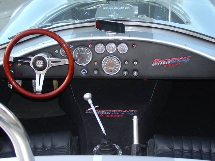

Anyone interested in a real face lift?

Ok Cashburn I'll bite- how much and does it come with a pair of sun glasses

Add up the cost of the gauges and switches and you can have it for that if you really want it. It does not reflect since we put the swirl pattern in. Tom has it on his, he has not run into anything yet
