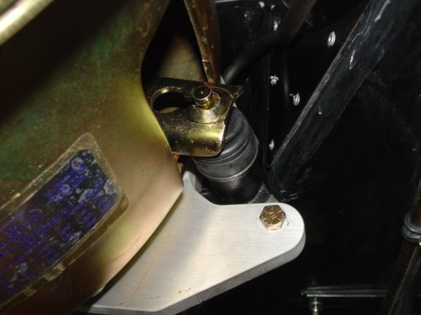

I started using these on the last couple cars that we have built at GCPC. I hope Mike and Greg make some good comments.

Does that assembly fit in the transmission tunnel when you use the rear engine mounting holes with a small block? I found that I had to use a pull-type slave pointing toward the front with the larger diameter of the steel scattershield bellhousing, or there would be clearance problems.

You have an earlier car. Later cars have wider tunnels.
Bill,
Looks like same old slave with a new bracket? Hard to tell on wireless while driving to Hershey... Never found the actual bracket to be a problem...

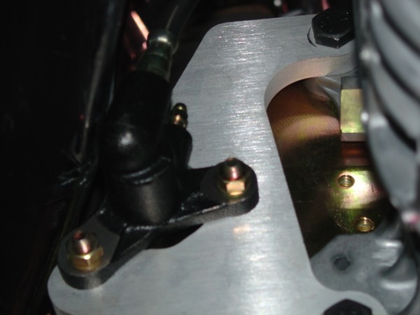

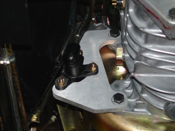

Our last 5 or so have had this in different dress based on transmission and bellhousing style:

never had much of a problem but never have like the dimension of the the older style bracket. This puts the push rod angle where I want it. I don't have to drill into the bell housing at all. Plus it allows me to install the bleeder up top easier.
I have plenty of slave cylinders if someone needs them. It uses a different a ford pick up slave now.

Cashburn, I'd be a little worried about the reliability of hydraulic connections with that setup, since the whole slave moves when you depress the clutch. Can't you flip it around and use a longer shaft to hook to the clutch fork?

Most motorcycles use the same braided lines on the brake & clutch, think when the forks move up and down, it's far more movement on the clutch / brake connections at the bars, than the 1 inch or so that the slave moves. I would not be concerned about the connections, or the lines.

And since it is a brake line...
I will make you a bracket Shaun, next time we fab one I will do 3 (one for Reg). You have Lakewood bell right?
